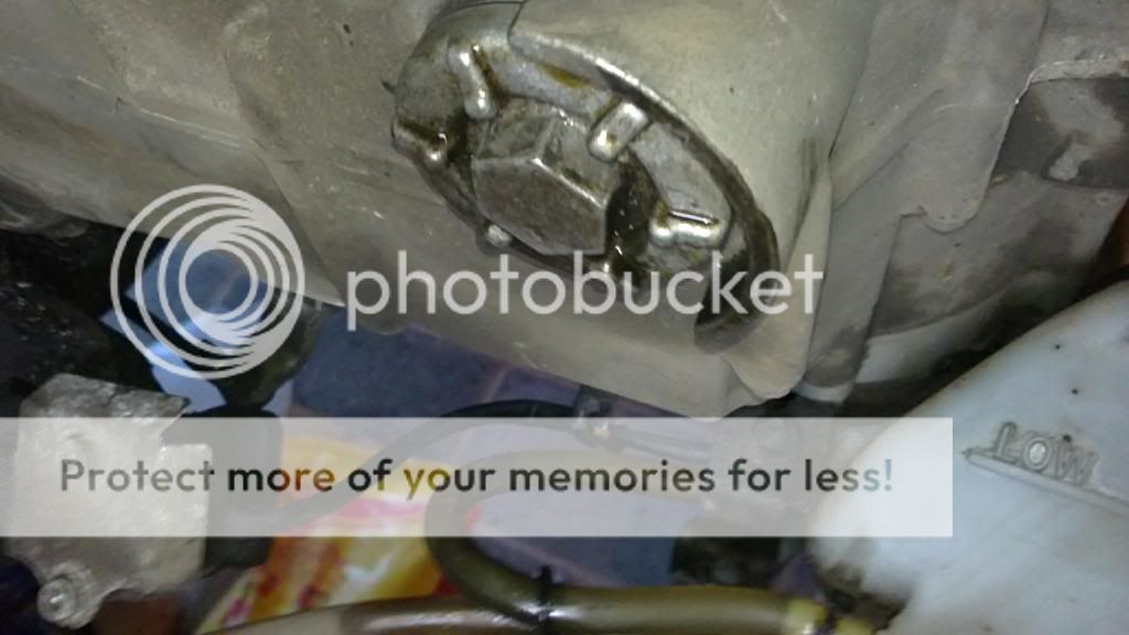

https://i192.photobucket.com/albums/z261/yearzer0/Sumpplugr125_zps82a96281.jpg
I've been using a ring spanner but, those protruding metal bits surrounding the actual bolt that you can see in the picture (not mine btw), prevent the socket from slipping all the way down onto the bolt. Maybe I'm using the wrong type of tool?

That's a weird-looking sump plug. You sure it's the right bolt?
Yes hes got it off the YZF R125 forum (I just googled it)
Looks like theres a tool Rolling Eyes
Dave70
Joined: 20 Jan 2012
PostPosted: 09:31 - 08 Dec 2013    Post subject: Reply with quote
Yeah. I've changed the oil before on this bike. The last time the oil was changed though was by the mechanic when it was serviced. I don't want to put it in the dealers just for an oil change but, I don't know whether it'd be best to. If only for him to have a look and probably manage to undo it with better tools than me.
It seems that it's not that uncommon for this bolt to round off apparently. It's so soft you'd think it was made of lead.
Very weird. That looks like the sort of bolt that has an O ring in it. If that's the case it shouldn't be very tight at all. It should just be nipped up.

PostPosted: 09:32 - 08 Dec 2013    Post subject: Reply with quote
Yes it's the sump plug, they can get very tight.
You need a good 6-sided socket on that. If you have access to a grinder I would grind the socket end to get rid of the lead-in and give you maximum purchase on the hex.
You could also try going for a ride and getting the oil nice and hot, then applying a cloth fully of icy-cold water to the plug before quickly using the socket, but really a good-fitting socket will do it.

They do have an o ring. As suggested above, try a socket, I had no problems with them when I had an R125.

Get a mate to sit on the bike, & then attach a DECENT socket or one of those Irwin gripper things to biggest breaker bar you can find/borrow/steal & it will crack open no problem.
Then dump the bolt & replace with standard sump with copper washer.
Yamaha used these drain plugs on a few bikes and they are a royal pain in the ass. Despite the odd configuration of the head there is no 'special' tool to remove them, just a good quality close fitting socket. They are M35 thread and installed fairly tight at 32Nm.
If you've damaged the hex already to the point where a socket won't grip then try using a flat drift on the ribs, you just might be able to start it moving.
