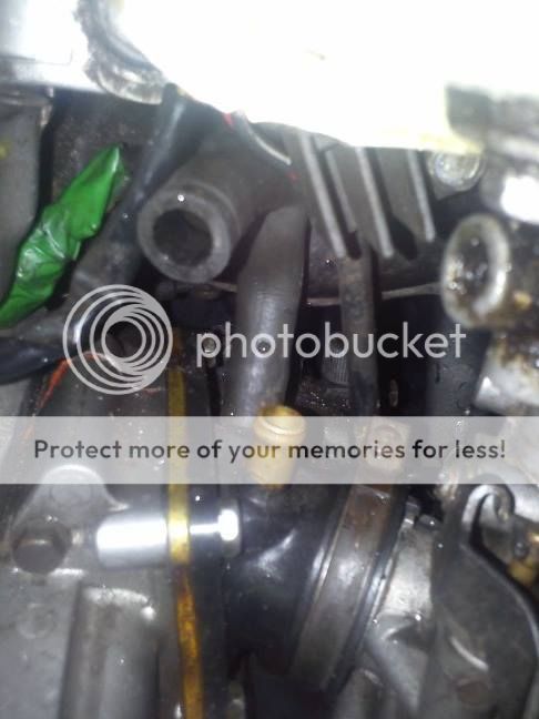

the bike has been fiddled with by some sort of 'chav' before and ive noticed that the intake manifold rubber has two pipe nipples coming out next to each other facing upwards, they both lead directly into the intake rubber but someone has cut a pipe and joined them together using the same pipe, if this is unplugged when the engine is running it automatically revs its bollocks off due to the increase of air.

yep we did the piston kit, got the right compression, runs the same! the old one wasnt even that bad, just changed it as we had a new one here. il upload pictures about the intake manifold in a minute!

https://s1176.photobucket.com/user/MattWadz/media/TSR125INTAKE.jpg%20
https://i1176.photobucket.com/albums/x322/MattWadz/TSR125INTAKE2.jpg?t=1388699920%20

Those stubby things on the manifold I would guess that they are supposed to connect to some sort of plenum chamber thingy, at least that is what I have seen in the past.
Perhaps Mr Chav has thrown the plenum away and put some old crap bit of pipe on it? I do wonder if your engines running lean due to a defective crank seal perhaps on the flywheel side? maybe it's sucking in air through that? I'd expect tons of smoke if the primary drive seal was defective.

The intake manifold pipe is suzuki's version of yamaha's boost bottle found on the lc's. Same as the RGV250.....they just use a length of tube to absorb the kinetic energy of the intake charge and in theory dump that same charge back into the intake when on the intake stroke. It does look odd if you've not seen it before but that's how it's supposed to be. It does sound like you've got a lean mixture on the idle circuit thus better if you lift the needle....so if you don't have air leaks or bad crank seals. Try turning in the air screw by a turn and see if that helps. Not unknown for it to be that simple sometimes!
Edit. On the track RGV's a std mod was to cut a pipe as short as possible to link the 2 intake holes together.....mostly because we set them up for WOT and little else so harmonics or road manners was not an issue.

So that pipe should be longer than t is ? It has been shortened because its kinked! Will make it leaner tomorrow and reply back

Yup so Long as it does not leak tbh it makes stuff all difference Suzuki even made an intake manifold with no brass outlets available from the race kit catalogue for the RGV. I can't say for sure with the TS carb but it's richer you want to make it....the screw is an air bleed jet..ie more turns out allows more air in rather than fuel so screwing it in makes it richer not leaner....which sounds like what you need. Also hope you set up the power valves properly if you fitted the new piston as these fail easily if setup wrong....and they need setting up with the exhaust off the bike as due to play in the pulley due to wear makes the factory stamped marks pretty off the mark. .....single Grey wire on the TSR under the tank/ air box area is used to earth the power valve controller in the closed position ....unplug that also gives you a working power valve !!!
