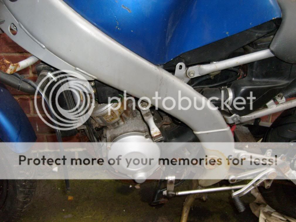

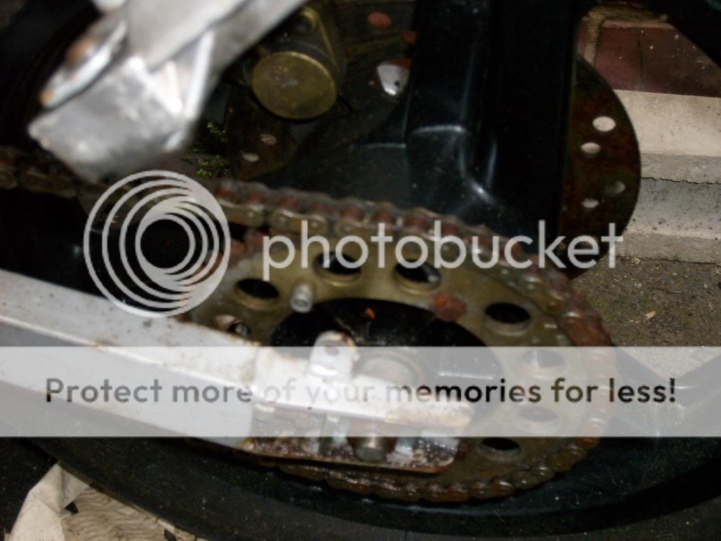

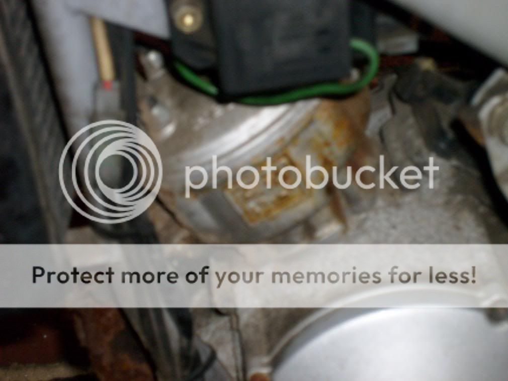

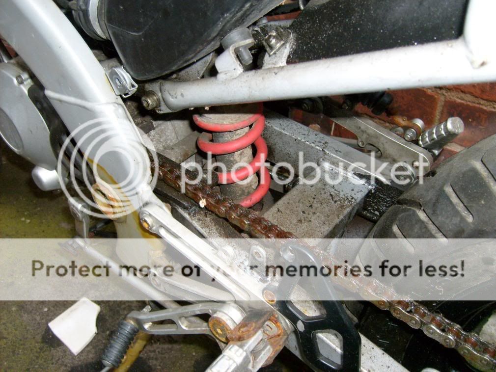

I took some pics earlier. When I tried to get it out the corner the wheels wouldn't move maybe chain and sprocket? as the chain was solid no movement at all!
Also panels are bit shabby but know someone who is bit of a dab hand when it comes to that sort of thing and will get it looking really good
Engine wise was thinking something like Aprilia rs50 or maybe 125 if it would fit but anything as long as it works Very Happy any sugestions?
Anyway heres the pics let me know what you think

Looks just like mine but rusty Very Happy
Ok, do a quick check to see if its worth keeping the engine and using that one.
Remove the spark plug, pour some 2 stroke oil in, lots!!!
Attach a battery and connect, press the start button. Do not hold it on, just see if it turns over, don't keep turning it over as you may damage something in the engine as you don't know the condition.
See if it turns over. If not it is seized which could be freed up but on a high rpm bike like this it probably won't do it any good.
If it does turn over then you may be able to get it running.
Report back to us when you have done that.
The engine is pretty much the same as rs50 etc but different years have different engines. Yours looks just like mine but unfortunately I don't have a spare. If you need any parts apart from the engine, I have them, forks, yolks, radiator, wiring loom, frame bits, brake callipers etc etc.
