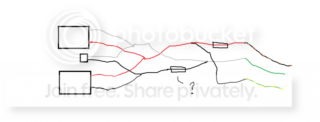

Right im admitting defeat on this one. The crappy led undertray has given me nothing but hassle since i bought the bike. Im attempting to rewire it but i've hit a blank and im getting nowhere.
This is what im dealing with...
https://i979.photobucket.com/albums/ae271/RxsOllie/wiring_zpsbcc273db.png~original
How do I need to connect it, resistors etc to get the tail lights/brake lights/number late light working? However I try and connect it I cant seem to get it right.
If standard undertrays weren't impossible to find i'd be alright...
Appreciate any help.

Are the indicators built into it and are LED too?
For LED I'd put the resistors on the positive side of the indicators.
Are they coming on at all? Flashing too quickly? What's happening to the brake light?
At work so can't edit your picture, sorry.

PostPosted: 18:31 - 08 Feb 2014    Post subject: Reply with quote
Indicators are separate standard bulb affairs.
I cant get anything to work, tail lights or brake lights. Havn't a clue how to wire it up.

PostPosted: 18:35 - 08 Feb 2014    Post subject: Reply with quote
Indicators should share a common earth point, which each negative wire should connect into. Then you should have a the indicator wires from the loom connected to the positive of the indicators. Also they shouldn't require resistors if they're just regular bulbs.
The LED brake light may need a resistor though.

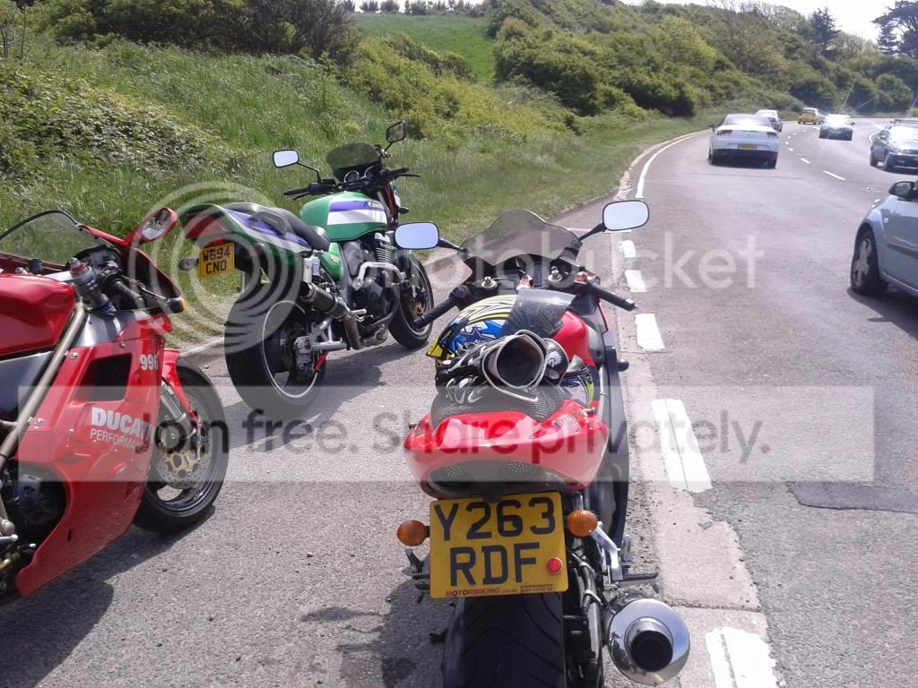

Looking back I wasnt that clear. Its a twin led setup, both are tail/brake lights. Indicators are completely irrelevant. The little box in the middle of my paint diagram is the number plate light.
Like so
https://i979.photobucket.com/albums/ae271/RxsOllie/2013-05-26120925_zps7f1623b6.jpg~original
Is that more useful?

salem1987
Joined: 10 Sep 2013
PostPosted: 20:12 - 08 Feb 2014    Post subject: Reply with quote
for the sake of working out what does what on the loom, i would earth all lights to the frame.
Then test each wire from the loom with the lights on, brakes on, indicators on etc.. with the new lights.

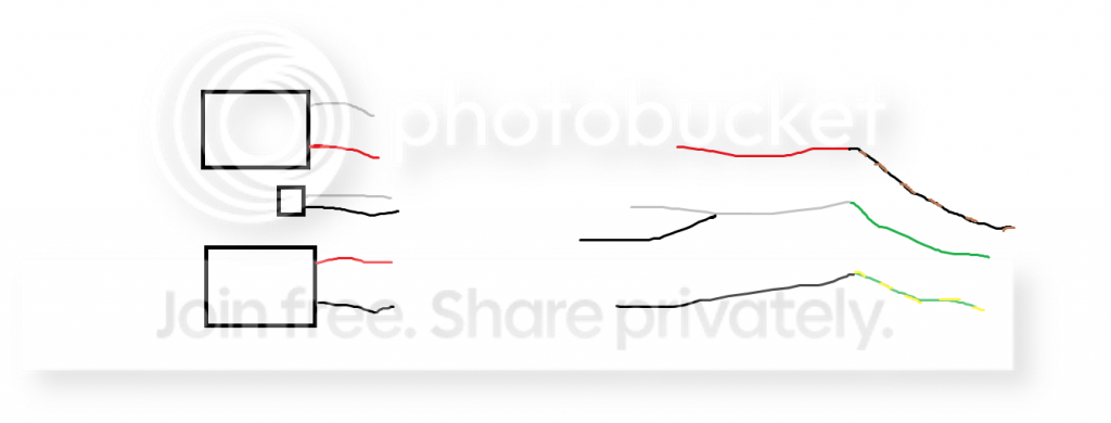

Currently have it wired in like so..
https://i979.photobucket.com/albums/ae271/RxsOllie/wiringaltered_zps975f30a3.png~original
Like that the left hand side light has tail and brake light working fine but the right hand side has 5 or 6 leds lit up around the edge at brake light brightness consistently and thats it....
Also there is a mystery heatshrinked component in the earth feed as marked above, another resistor?
