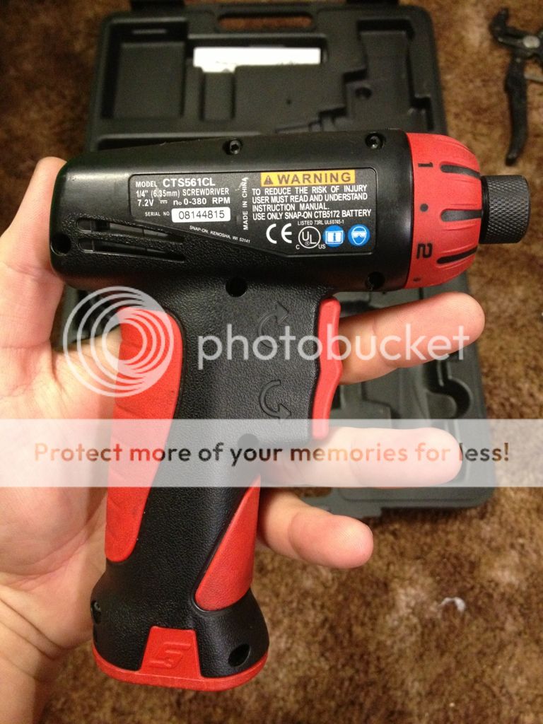

Coxyzxr
Joined: 22 May 2008
PostPosted: 19:20 - 07 Apr 2014    Post subject: Reply with quote
Right,
Back at work today and given it some direct thought as I was working on bikes today and reading through replies here I definitely think it'll be a big time saver.
As I work in a main dealer we get LOTS of new bikes come in which always require the same things to be bolted on and assembled which always means fairings off then back on one stuff fitted, almost to the extent of it being slightly production lineish - so it's going to be a big help in that regard.
I'm looking at something lightweight and reasonably low torque like this or the one below;
These can have the toque set so low you wouldn't even strip fairing bolts. Plus the spindle lock on the snap on allows you to do the remaining torque up by hand.
I'm gonna grab buy one on Weds and see how it goes. Though the snap on is costly (obviously, it's snap on??) I still have to decide whether I can justify that cost.
Thanks for all the input.

PostPosted: 19:33 - 07 Apr 2014    Post subject: Reply with quote
I'd go cheapish to start with.
Not the end of the world if it breaks.
My 18v and 24v cordless drills have had settings that will torque-out if you hold it with your little finger. Yet the 24v one could start a generator (maybe 250cc 4 stroke engine or so.)

DMCpro
Joined: 16 Jul 2012
PostPosted: 08:39 - 08 Apr 2014    Post subject: Reply with quote
Coxyzxr wrote:
Right,
https://www.toolhead.co.uk/wp-content/uploads/2009/02/bosch-gdr-10.8v-li-ion-impact-screwdriver-1.jpg
or this
https://i31.photobucket.com/albums/c392/tlee20/828A1921-60F1-473C-A745-26BC5357191B-6241-0000046A223A17AC_zps96338e70.jpg
The Bosch one pictured is a good tool not sure about the other one you posted (snapon?) but i use the Bosch every day even used it to assist with putting up a kitchen mainly use it on car and bike stuff though.
