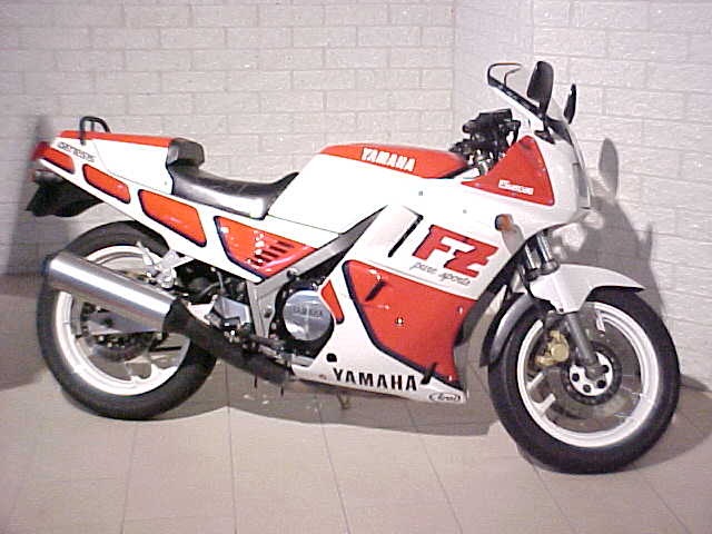

My FZ750 has had the fairings off for years and was even ridden with no mirrors at all so I wouldn't worry about it. It's gone from something like this ...
https://www.motorbikespecs.net/images/Yamaha/FZ_750__Genesis_89-91/FZ_750__Genesis_89-91_1.jpg
to this ...
https://i61.tinypic.com/2dsfhgn.jpg
Be prepared to be windswept on a motorway at full speed though.
