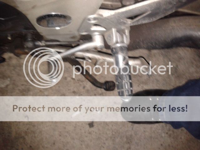

Hi all,
My bike is up for MOT next week and I've just given it a quick once over. The only thing that's not right on it is the rubber on one of the footrests is wearing away, here's a pic:
https://i1323.photobucket.com/albums/u587/mjs1066/20140328_205204_zpsad2e33e0.jpg
Will I need to get this sorted out or is it alright? Being a tightfisted Yorkshireman I'm quite happy to leave it that way and just call it good old patina Thumbs Up
Cheers,
-Mark
SQL
Joined: 09 Aug 2012
PostPosted: 00:03 - 09 Apr 2014    Post subject: Reply with quote
Tape it
Matt B
Joined: 01 May 2012
PostPosted: 11:26 - 09 Apr 2014    Post subject: Reply with quote
The MOT manual lists a fail for a missing or insecure footrest only.
https://www.motuk.co.uk/mcmanual_620.htm
However, some testers are prone to making up their own rules.
PostPosted: 13:16 - 09 Apr 2014    Post subject: Reply with quote
Having no rubber is not a fail. My usual MOT guy went and checked the manual as I was concerned regarding my monkey bike. He said, nope, no mention or rubber/non slip, just "footrest secure" Thumbs Up
