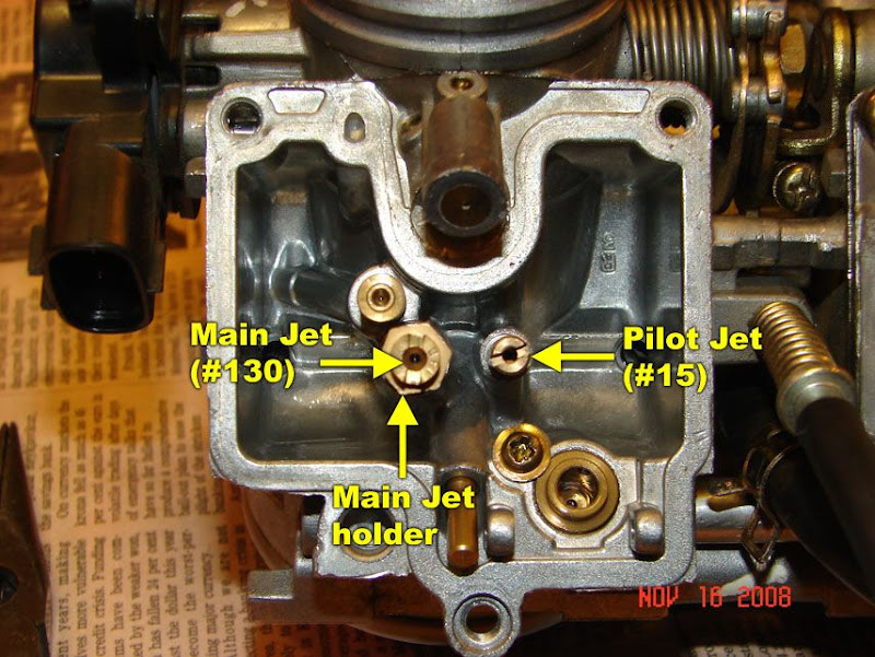

1. remove carb from scoot
2. remove float bowl (the BOTTOM of the carb )
inside you will see some thing similar to this
https://lh4.ggpht.com/_V3xFv5XAQi4/SSdPFrW275I/AAAAAAAAAQY/SeNM5pYUu3Y/s800/carbs%20007%20copy.jpg
The main jet is the biggest one, it will have numbers on it.
3. buy the next 3 sizes BIGGER main jet ( yes buy all three jets )
4.Try each jet one at a time until you find one that runs the best - if its the biggest one take smaller two back and swap for the next two bigger sizes so you can try even bigger jets.
5. You should end up with one jet that runs good, the next size will be ok but a bit rich and the next one up will probably be crap.
Make sure bike is well warmed up before deciding if a jet is good / bad, take it for a good ride - but DONT hammer it. A jet that is too rich takes about 10mins to foul the plug and start causing trouble.
A jet that is too lean will make engine run very hot and you will seize or blow it up.
Be sensible and logical and you should get it near right.
Chance are you'll bin the new exhaust and put the old one back on lol

And just for the fun of it, here's a photo of the carb off my RXS I instagrammed last night. Main jet is in the middle, idle (pilot) jet on the left recessed in.
https://scontent-a.cdninstagram.com/hphotos-xpa1/t51.2885-15/10369430_719458784764422_213234889_a.jpg
