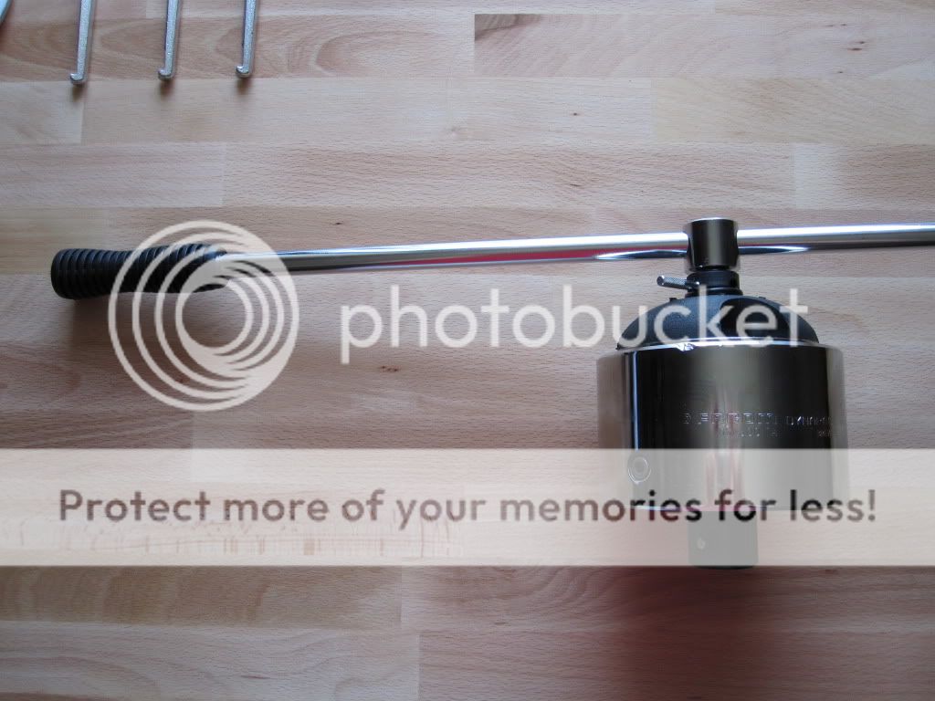

I 'won' a second-hand Makita impact wrench from the bay. I think that I paid around thirty squids for it and though it doesn't get a lot of use, it hasn't failed to undo anything that I've used it on so far. Mind you, it does knock-out just shy of 600 Nm's.
If ever I'm in a situation where power isn't available, I find one of these can be useful:-
https://i739.photobucket.com/albums/xx39/cantause/IMG_0378.jpg
D'ya know what it is yet?

yes, about £1500 worth of clever gearing system Wink
Hugh Farking Cant
Joined: 03 Mar 2012
PostPosted: 01:22 - 15 Jun 2014    Post subject: Reply with quote
It is a torque multiplier.
Remember; Someone on here always has a blacker cat.

Wrong

Looks like a Dynapact manual impact wrench.
Always wanted to try one. Arent they suppose to have like 1000Nm of torque?

Raffles wrote:
Wrong
Howay then; clever cunt :
Infact ; Unless you name is Francois from Belguim;
You took the picture from this thread.
https://www.garagejournal.com/forum/showthread.php?t=65386
Facom dynapact 3/4" 2000Nm
Manual impact wrench Torque Multiplier 3/4" drive.

Torque Multiplier;
https://www.ebay.com/itm/Facom-3-4-Drive-Dynapact-1000nm-Manual-Impact-Wrench-Torque-Multiplier-NK-300-/231158923035?pt=UK_Hand_Tools_Equipment&hash=item35d2253f1b

It's mis-named calling it a multiplier IMO. A proper multiplier requires a reaction arm.
That thing stores rotational energy and releases it in a burst which is exactly what air and electric impact guns do, just that they do it many more times a second. The main different in my eyes is that you can properly measure the tightening torque of a multiplier but that tool is just a highly-variable estimation based on several factors.
