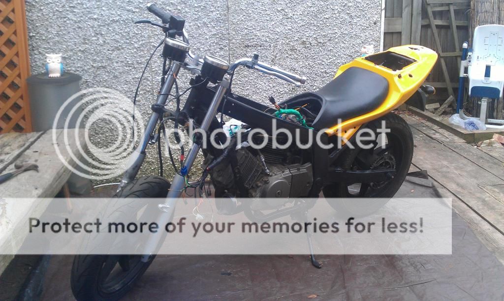

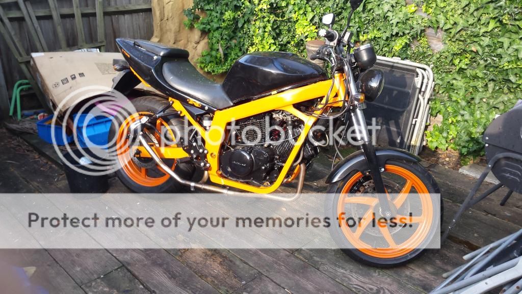

My r attle can paint job
Before
https://i779.photobucket.com/albums/yy72/photo_w87/Mobile%20Uploads/IMAG0198.jpg
After
https://i779.photobucket.com/albums/yy72/photo_w87/Mobile%20Uploads/20140723_073831.jpg
Petrol will cause havoc with Halford tins (I know) and their lacquer is wank. Wouldn't resist a heavy shower let alone fuel but good results can be achieved however it is costly and time consuming.
