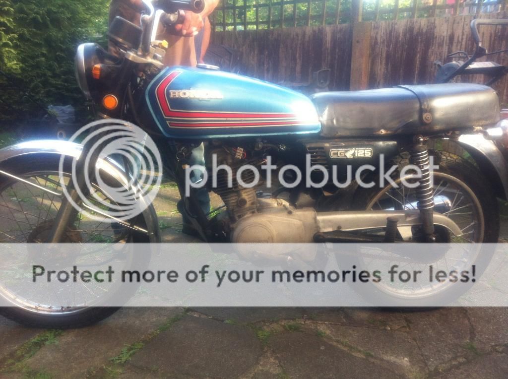

Not quite as a far as full resto but clean up & get running (running without a death rattle that is Razz). Previous bottom end was missing a bearing from the gear shaft that slots the clutch basket on so sourced one from a breakers & cannibalised the bits I needed hence stripping the bottom end.
Pic from when it was first acquired
https://i1211.photobucket.com/albums/cc425/8Moxey8/CG%20125/IMG_03881_zps5d14ee3a.jpg
Doesn't really need much restoring though if you ask me, got it for a fraction of what some dreamers are asking for total wrecks too.

Nice chrome mudguards, stylin
Café racer style, classic
A dose of ACF50 and a bit of TLC and it'll be AOK
The work horse itself Thumbs Up
I've got most of a CG in my front room as well as the one I ride to work Razz

Wow, CGs really had tiny front drums back then, my brakes are terrible, how does that thing even stop? Shocked
Simple, by pulling the lever. Laughing
As I see it, roads were clearer, cars didn't slam on the brakes at junctions, and attitudes were calmer.
Also, it made ordering drum shoes easy, as I believe they are the same size front and rear.
