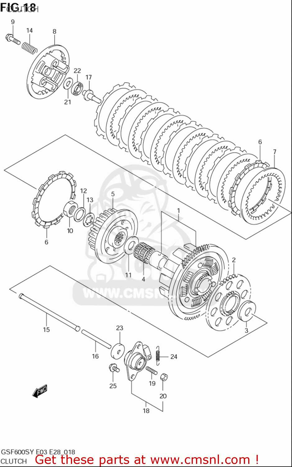

I believe it's No.16 on that diagram snapped (it's roughly 8cm in length). It's been replaced now and the bikes all good.

_Iain_ wrote:
Pics plz.
I'll post one up later tonight, i'm 98% sure it's No.16. This is the part that I ordered and had replaced, now the bike works.
