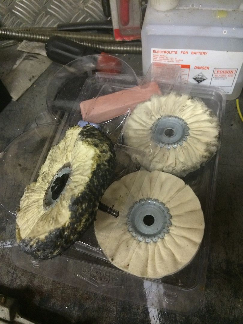

PostPosted: 22:04 - 31 Mar 2015    Post subject: Reply with quote
Mo powah! You need enough to get the part hot and to melt the polishing soap. If you can stall the mop without risking losing a digit - mo powah!

I'm using a fairly decent corded drill, the part gets warm but I wouldn't say hot. I have been using it with the part in a vice and moving the drill round it it. I might try either using another drill we have that has a pillar mount. Or put the drill I have been using in the vice and hold the part.
Anyway here is the part as was.

Using a drill is a good way to kill it, Drill bearings are designed for thrust loads, not side loads.
