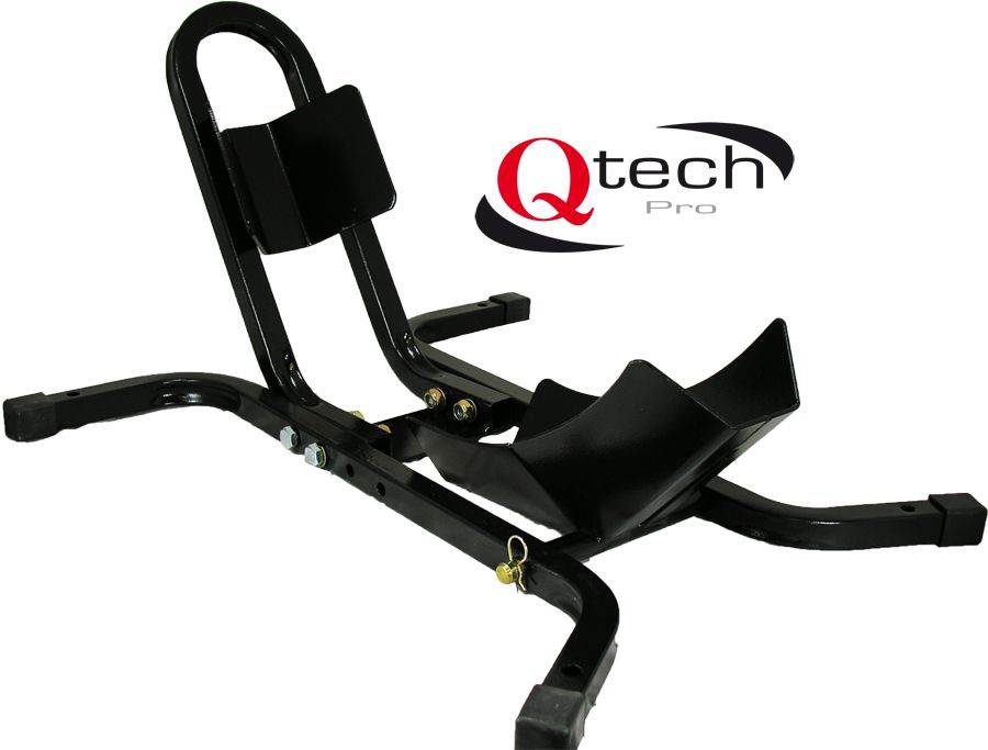

PostPosted: 18:13 - 27 Mar 2015    Post subject: Reply with quote
Now I'm on a PC rather than my phone, I can post pictures to show the types I mean! (Such a pity BCF doesn't have a mobile version, or work with Tapatalk!)
These ones start at around £30 on eBay:
https://i228.photobucket.com/albums/ee149/leaforge/Stands/Stand7c.jpg
These ones start at about £12:
https://i.ebayimg.com/00/s/MzUxWDQwMA==/z/-sAAAOSwPhdVE989/$_12.JPG
The top one looks nicer, but there is a fair difference in price.
Will the bottom one hold it securely enough in a trailer? It will all be strapped down, but will be going on the motorway...
The plan is to make it detachable from the trailer, mainly so it doesn't get in the way of the trailers other uses, but also so I can put it in the van if required.
In the end I'll probably want two, so I can use the trailer as a single bike or double bike trailer.
PostPosted: 18:17 - 27 Mar 2015    Post subject: Reply with quote
With the bike(s) strapped down, wheel chokes are unnecessary.
You'll just need some eye bolts or other anchoring points in the trailer.

PostPosted: 18:44 - 27 Mar 2015    Post subject: Reply with quote
I've just fitted some new tie-downs to the trailer, as I just replaced the floor as well, so I should be able to strap it down securely.
But, the floor is OSB painted with a bitumen-type paint. If it even gets slightly damp I think it will be pretty slippery. My worry is that if the tyres slip, the bike will fall over.
I've only ever transported bikes in minibuses before, so the seats prevented any chance of them falling over. I've never used a panel van or trailer for it before!
I can't remember if the bike has a centre stand or just the side stand either...

PostPosted: 14:54 - 28 Mar 2015    Post subject: Reply with quote
After much pondering I think I'm going to try bringing the bike back with no wheel chock.
If I'm not 100% sure it'll be secure enough I'll leave it and bring it back another time, after buying a wheel chock.
I'm hoping to grab it wednesday, so time is against me for postage anyway.

It should be fine. What makes you think the bitumen paint would get slippery?
If you are concerned with sideways movement then just grab a couple more straps and use one on each wheel. Take a turn around the wheel as low down as possible and this should prevent any movement once the straps are tight.
People tend to overthink bike transportation and go overboard, I usually only ever use three of these to tie a bike down with...

CX?
not that heavy, put it on the side stand in first and use some ratchet straps
like they do on ferries, it'll be fine.

PostPosted: 11:28 - 29 Mar 2015    Post subject: Reply with quote
Strap it properly, stick it in gear/cable tie the front brake lever on (if possible) and drive sensibly and you'll be fine.
