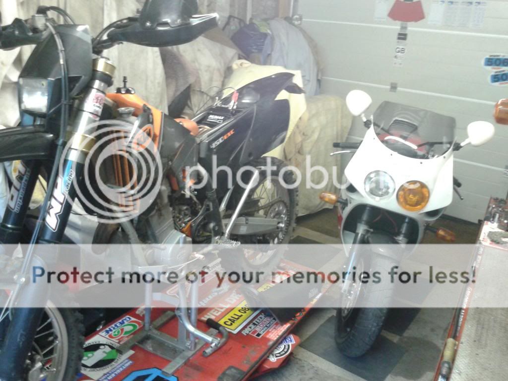

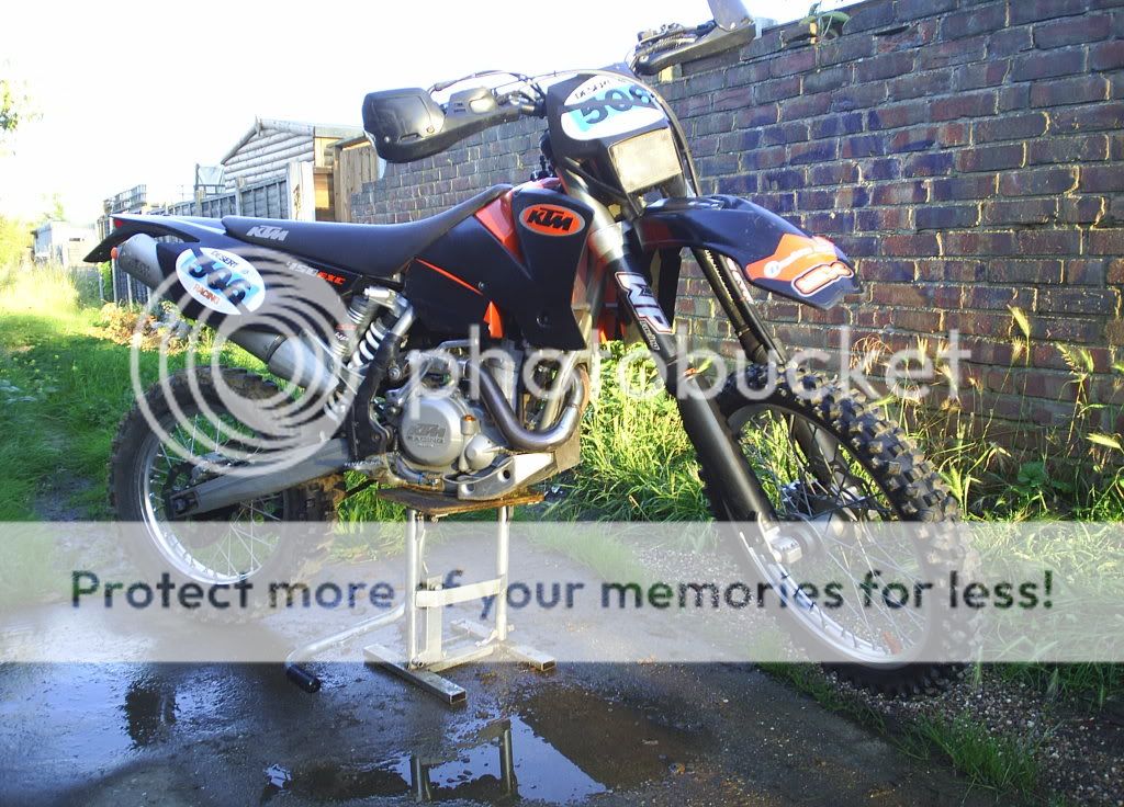

Most one step stands would be suitable for a CRF250L.I have two,one for each dirt bike
https://i666.photobucket.com/albums/vv23/WiNot_Rhencullen/Honda%20750/My%20bikes/Picture002-2.jpg

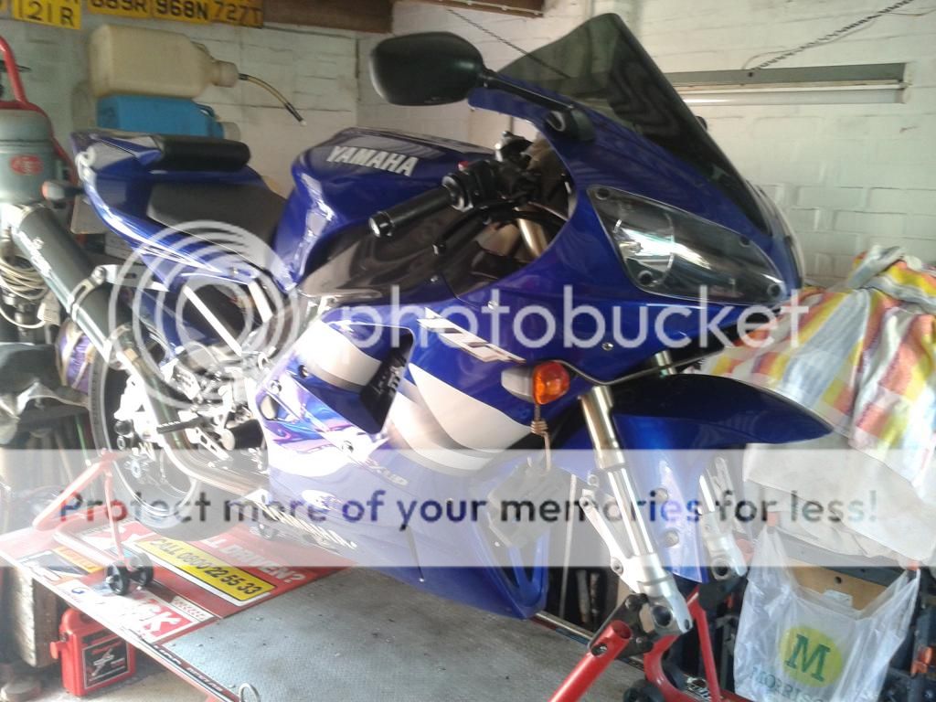

But the best way to work on the bikes is to use a proper lift (I was given the second one Very Happy )
https://i666.photobucket.com/albums/vv23/WiNot_Rhencullen/Workshop/Picture394.jpg

PostPosted: 23:47 - 20 Nov 2014    Post subject: Reply with quote
Still need something to lift it off the stand to do stuff to wheels etc, so back to the same problem Smile.

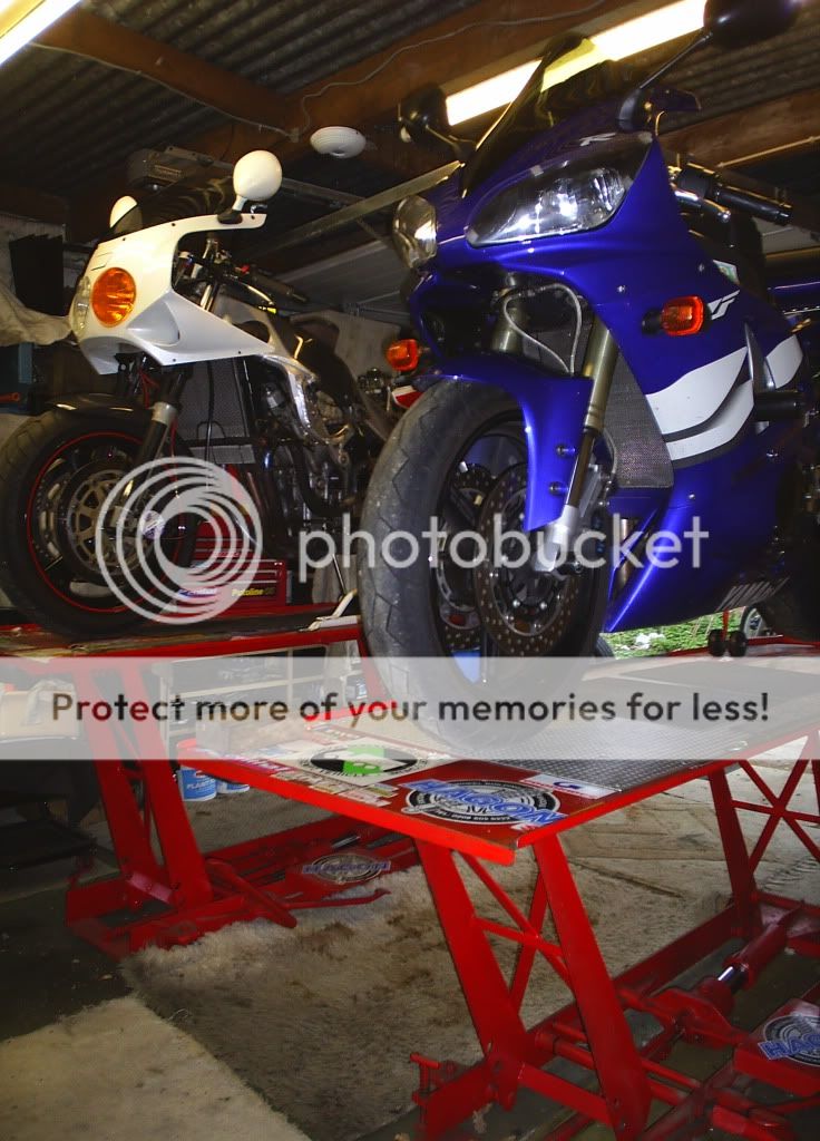

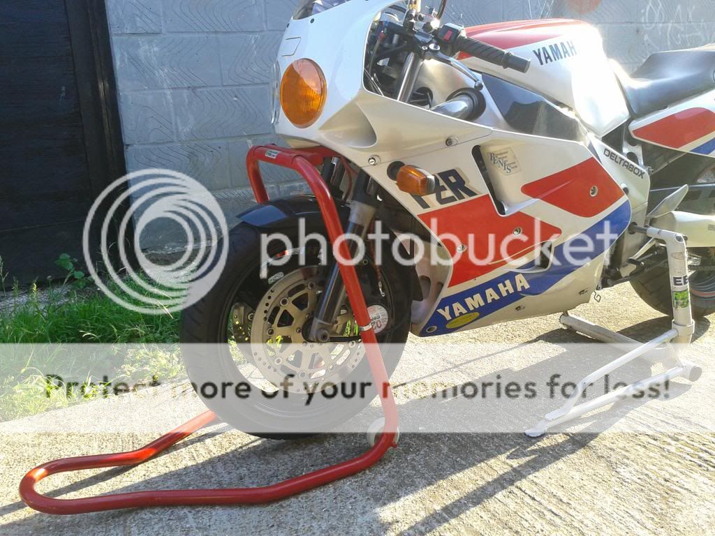

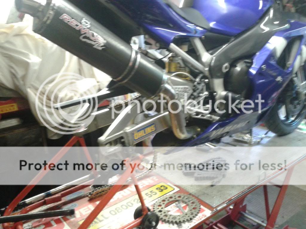

https://i666.photobucket.com/albums/vv23/WiNot_Rhencullen/Workshop/2014-05-02192704_zps730a6612.jpg
https://i666.photobucket.com/albums/vv23/WiNot_Rhencullen/Workshop/2014-05-02192411_zpsc03c1ca6.jpg
https://i666.photobucket.com/albums/vv23/WiNot_Rhencullen/Workshop/2013-09-05153447_zpsbc81ec45.jpg
https://i666.photobucket.com/albums/vv23/WiNot_Rhencullen/Workshop/2013-06-06183932_zps24966dc6.jpg
With the right stands then the work is easier to do.
If I had to start again I would have bought the ABBA stand and the box of adapters Thumbs Up
