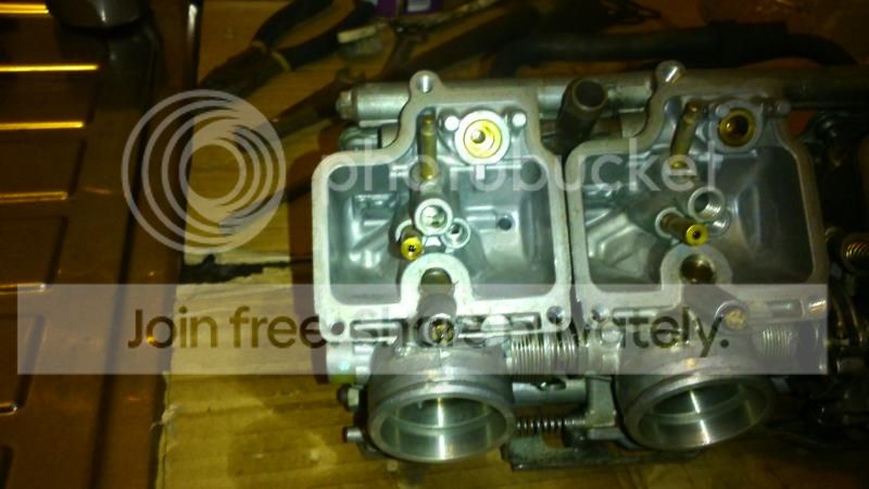

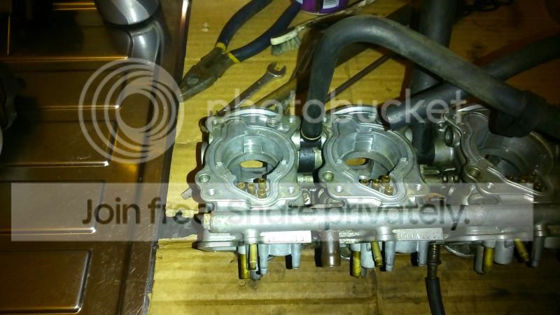

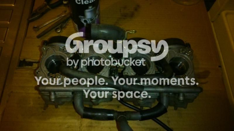

andym
Joined: 16 Nov 2010
PostPosted: 22:52 - 15 Feb 2015    Post subject: Reply with quote
They are fairly simple to do, (don't know if there's much of a difference between the 92 model), most awkward part is getting them off in the first place.
A complete strip clean and rebuild should take an hour (maybe 2 if you are learning on the way). When you are refitting them you will need a phillips screwdriver that will reach the side of the bike to the first carb (I got one for £3 from a tool store)
Done mine last weekend:
https://img.photobucket.com/albums/v320/andy36586/DSC_0390_zpsbdomsynz.jpg
Remember to spray in all of the holes at the bottom of the carbs (as one of them was blocked in mine and I'd already cleaned the jets):
https://img.photobucket.com/albums/v320/andy36586/DSC_0392_zpsppxjlram.jpg
https://img.photobucket.com/albums/v320/andy36586/DSC_0393_zps9180csmm.jpg
https://img.photobucket.com/albums/v320/andy36586/DSC_0391_zpsazjkvblq.jpg
https://img.photobucket.com/albums/v320/andy36586/DSC_0394_zpsi1ggrsdn.jpg
