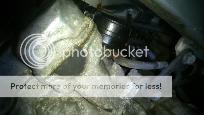

It's a poor photo but if it was a clock face then this would be at 7 o'clock, which is easy enough for the first carb (if it does go from left to right, but add the carbs and it would be a lot of guessing to find the right place:
https://img.photobucket.com/albums/v320/andy36586/DSC_0386_zpsbb4fphip.jpg
Both my GPz and ZXR were very easy to balance (with my homemade manometer too), and only took a few minutes.
mentalboy, I was thinking of doing something along them lines, there is currently screws covering the holes in the engine (apart from 1 (or is it 4), obviously). If I could borrow the fittings then I would get it done and leave it at that as I've never had a bike long enough to need to balance them again..... and I begrudge paying for something that I can make for a fraction of the cost because Honda were being a bunch of c**ts when they designed this part

I seem to recall that when I set up the permanent extension pieces the only way I could do it and retain most of the skin on my knuckles/sanity was to remove the carbs. Ballache the first time but so easy every time thereafter.

PostPosted: 18:01 - 20 Feb 2015    Post subject: Reply with quote
oh !! happy memories of carb balance on a Honda cbr motor..
on the cylinder head...
iirc.. the vacume pipe to the fuel cock is the first connection to the gauges... yes ?????
the other three are a simple blankin screw ... yes ???

mentalboy
Joined: 05 May 2012
PostPosted: 18:21 - 20 Feb 2015    Post subject: Reply with quote
Sounds familiar - simplicity isn't the problem though, it's finding a small child with ten inch long multi/double-jointed fingers!

Copycat73
Joined: 11 Jan 2013
PostPosted: 18:30 - 20 Feb 2015    Post subject: Reply with quote
I ordered three of the adapter screws & rubber covers one already fitted for the fuel cock ..
removed the carbs fitted them after that balancing was not a problem.

it was some time ago ... in the days when peeps went to their local dealer for parts ... but here is a parts diagram online
https://www.motogrid.com/pages/OemParts?aribrand=HOM#/Honda/CBR600F2_A_(92)_MOTORCYCLE%2c_JPN%2c_VIN%23_JH2PC250-NM100001_TO_JH2PC250-NM107517/CYLINDER_HEAD/CBR600F2-92-JPN-A/2Y14MV9MMV94E0200BB
items 16, 6 (5mm screw), 23, 7.
but you need to cross check wit your bikes equivalent part numbers
