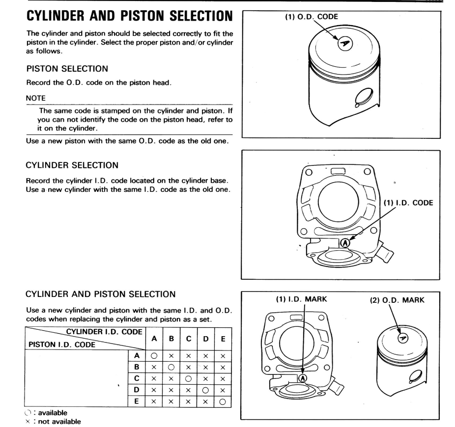

rings at an absolute minimum, but previously i've just bought a piston "kit" containing piston,rings,gudgeon pin etc. & i usually go for the best piston i can afford.
for the nsr, i would remove cylinder & look for the code (a,b or c) & buy the coresponding vertex piston kit. double the price of some other pattern pistons but the piston & rings isnt something i would skimp on,

I have located a Piston kit by 'Vertex'.
They have three different sized pistons - how would I know which one I want?

Finnian3 wrote:
The code should be stamped on your piston head and cylinder.
https://i.gyazo.com/12ddb4f9a5f9bf17bcc6d188a39634a4.png
Okay - so far example my piston maybe be a (B) and the cylinder will match (B). Therefore I should purchase another B?
Thanks matey Smile
salem1987
Joined: 10 Sep 2013
PostPosted: 10:27 - 12 Mar 2015    Post subject: Reply with quote
yes.
Before purchasing though check the cylinder bore for smoothness. Shouldnt be able to get your finger nail stuck in any scratches for example.
If there are some serious scratches, its nikasil so will need replating or a replacement barrel. It might be wise to take the barrel to a local bike garage and ask them their opinion if not sure, 30 second job for them, im sure itll be for free!
