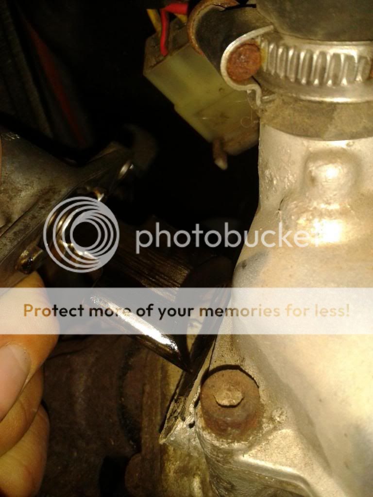

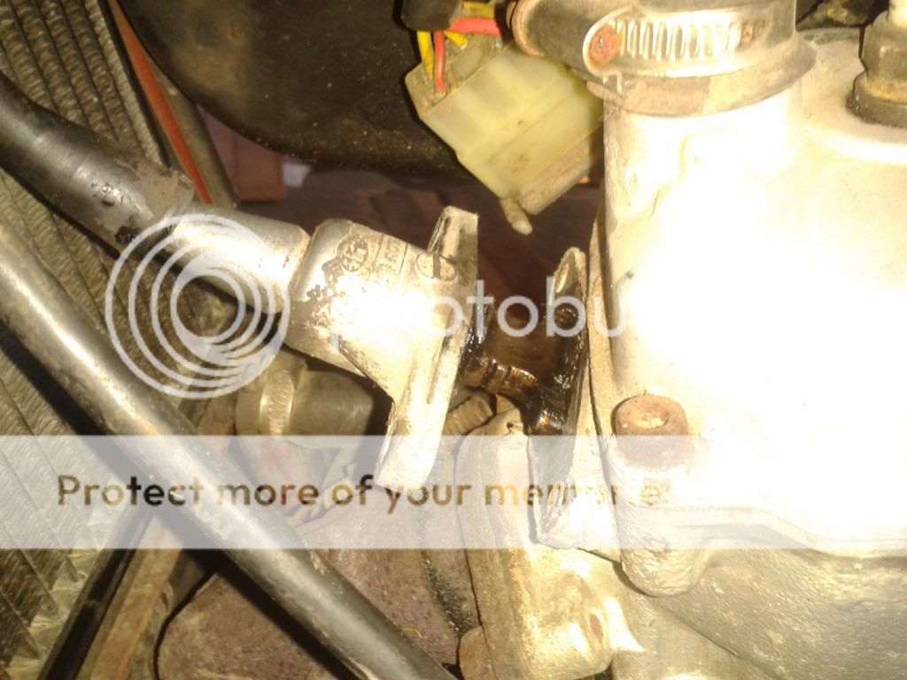

https://i1371.photobucket.com/albums/ag313/Igoriz/2014-05-19141125_zps5521be81.jpg
What could be the problem, it got stuck in this posistion. Should I just pull it out?

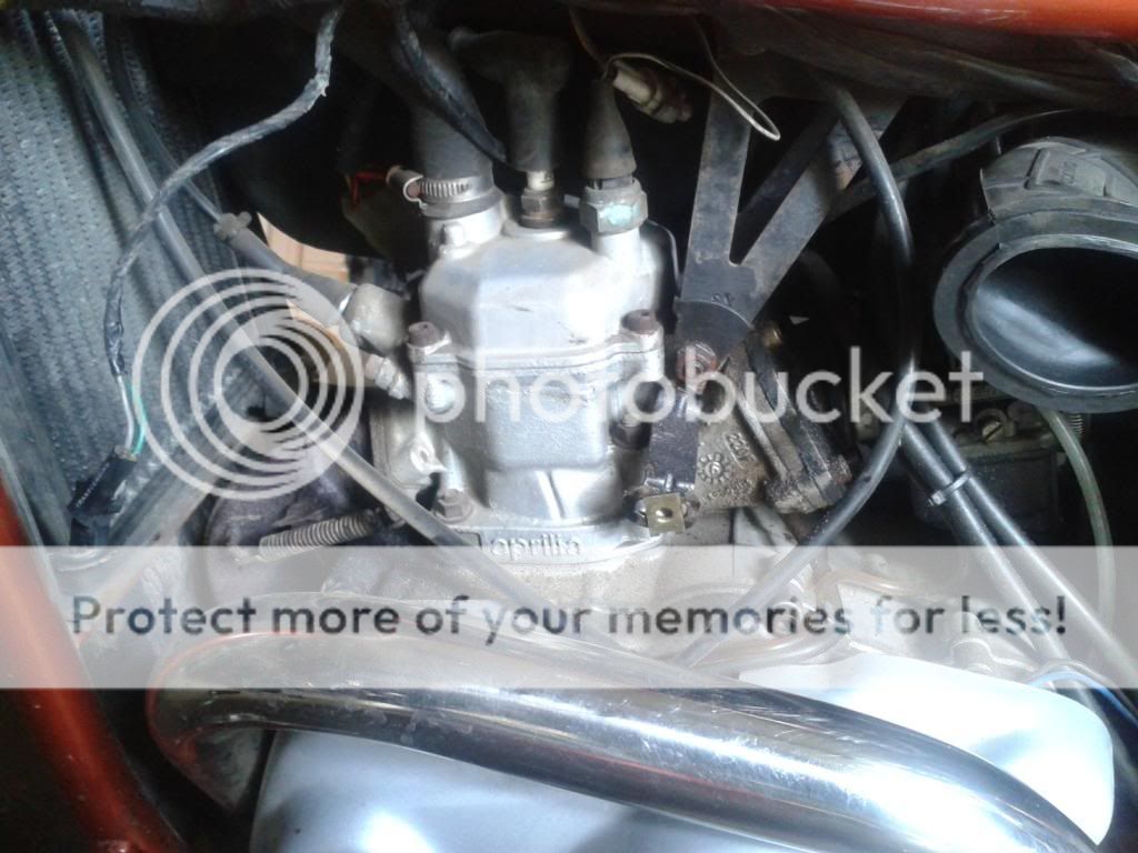

https://i1371.photobucket.com/albums/ag313/Igoriz/2014-05-19140358_zpsf22052e6.jpg
This is the engine. Dont know if its a 122 or a 123.
PostPosted: 19:31 - 19 May 2014    Post subject: Reply with quote
Probably a 123 (check the coil - if it is blue then that pretty much confirms it).
As to the power valve, spray a bit of penetrating oil on the blade and push it back in. Then pull out again, and keep at it. Better to move it many times that try and pull it hard (it is not unknown for the pin to snap off the blade). Keeping pushing it in and out and it should come lose fairly easily. Then give it a good clean up.

Another questions, should the valve's blade should be pointing up, or down?
Edit:
Is there any way to put in a RPM gauge?
PostPosted: 22:44 - 19 May 2014    Post subject: Reply with quote
Not much. Exhaust is the important bit, but without ruining the look not sure you can change that easily and not sure how good the standard one is. It isn't really a bike designed for performance.
The blade should go in such that the engine end of it is horizontal. Ie like this \_\ not like this \|

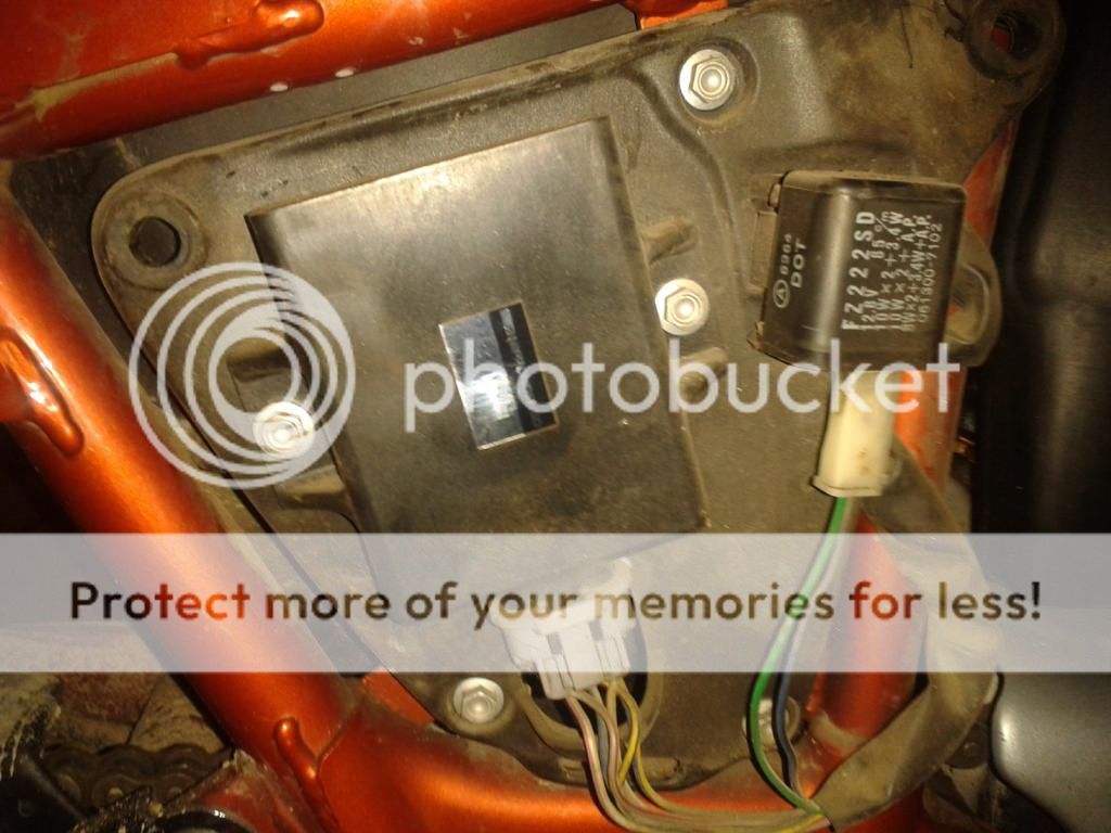

Does my bake have CDI?
https://i1371.photobucket.com/albums/ag313/Igoriz/2014-05-20105545_zpsf0a7edc2.jpg And is this the right way?

Erikas wrote:
Does my bike have CDI?
Yes it does. It's behind one of the side panels (not the one with the seat lock, the other side)

PostPosted: 23:55 - 20 May 2014    Post subject: Reply with quote
If a 123 engine then it probably has the SEM ignition and no separate cdi unit.
Can't tell from the photo which way up the blade is in that photo I am afraid.

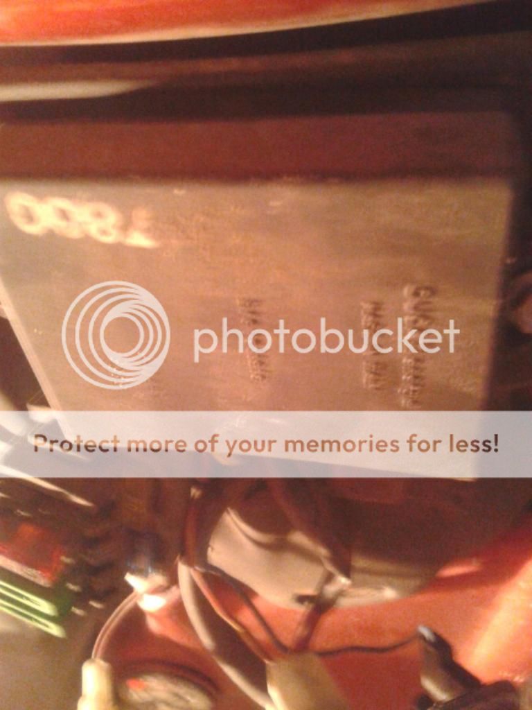

https://i1371.photobucket.com/albums/ag313/Igoriz/2014-05-21215903_zpsbdd1498b.jpg Whats this? It says DUCATI Energia on the side.
https://i1371.photobucket.com/albums/ag313/Igoriz/2014-05-21215929_zpsc148a0b8.jpg This also?
