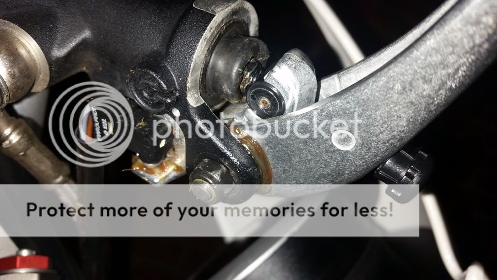

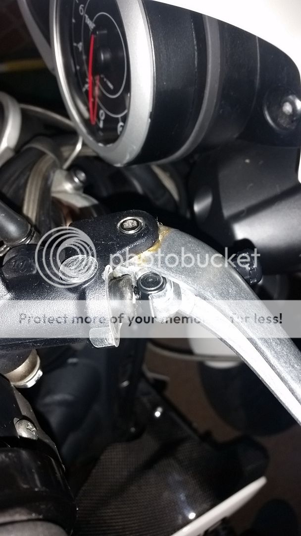

Sounds daft but the front brake of my speed triple has applied itself twice while I've been riding it, I haven't even been touching the lever. The second time this caused me to lowside the bike, luckily it wasn't at speed.
While the bike has been away getting repaired I've researched the problem. A few people seem to me to have had similar issues caused by the master cylinder piston rod not sitting correctly in lever. I've just got the bike back and now I've got a complex about riding it because I don't know if its safe.
Could anybody tell me if this looks like everything fits together correctly
https://i243.photobucket.com/albums/ff191/Quirky_06/Mobile%20Uploads/20150317_184259_zpsvrgbsbu9.jpg
https://i243.photobucket.com/albums/ff191/Quirky_06/Mobile%20Uploads/20150317_184248_zpscpzjediz.jpg
https://i243.photobucket.com/albums/ff191/Quirky_06/Mobile%20Uploads/20150317_184309_zpshgzxknuf.jpg[/img]

Looks fine, but if you are over paranoid swap the m/c for a better one.

I think the m/c is ok. I haven't had the bike long and i know the brake lever was changed just before I bought it so I'm thinking the lever wasn't fitted correctly but its all just guesswork.

is it a pattern lever or a genuine one?
if it's pattern it may be made badly, and slightly applying the brake in use, does it push the piston in when fitted?
I know of several problems caused by pattern levers, one mate lost his front brake pressure on his blade on track days as the heel of the lever was smaller than OE and it wouldn't push the piston in far enough to operate the brakes when hot, it was fine on the road, a new genuine lever sorted it
then there was that kid with the pattern levers on his street triple, the cheap lever was pressing on the piston so they were dragging, when the brakes got warm they locked up and threw him down the road

I have seen cheap chinese knock off brembo levers (and others) cause this, the levers are incorrectly made and fit but once bolted on apply slight pressure to the master cylinder piston causing a slight bind of the brakes which in turn does as Ariel Badger says.

Well the lever that was on before I crashed may have been pattern but i couldn't be sure. As far as i know, the one thats on now is OEM.
Thats what I've read in similar stories that ill fitting levers were causing pads to rub and overheat the system. Now the new lever has been fitted by the repairer I'm hoping its sorted but I want to be sure.
If i roll the bike forward I can hear a slight rubbing of the pads but no more than my last bike. How can I tell if its right when the moving parts are hidden behind the rubber boot of the m/c?

If the pads are binding, as long as the roller is not depressing the plunger when at rest, I think the problem is more likely to be with the seals in the caliper. If they are not allowing the pistons to retract, try stripping and cleaning the caliper, and fit new seals.

Yes what Ariel Badger says is correct. If the piston is held in a tiny bit the return port is closed off. Mine was an extreme case since I was shoving the bike along with 400hp so it got very hot indeed and it was 20 minutes before you could even wheel the bike. After it cooled you would not have known there was a problem at all.
Un-wind the span adjuster to pull the lever in towards the bar, then adjust it back out. See if adjusting it pushes the plunger in any at all.

There you go, you've found the problem. Now to find the cure.
BTW you could have the wheel turning immediately by cracking a brake pipe union and letting out a little brake fluid.

Your problem could be nothing more than the lever hinge bolt done up too tight. This would cause the span adjuster to push on the plunger rather than opening the span.
Squeeze the brakes then let them go. Push the lever away and watch the plunger. If it moves, loosen the locknut on the underside of the lever hinge and un-do the allen bolt a fraction of a turn to loosen the hinge.

The span adjuster being the nut on the rod that goes into the m/c??
If it doesnt move then the problem may have gone with the fitting of the new lever?
