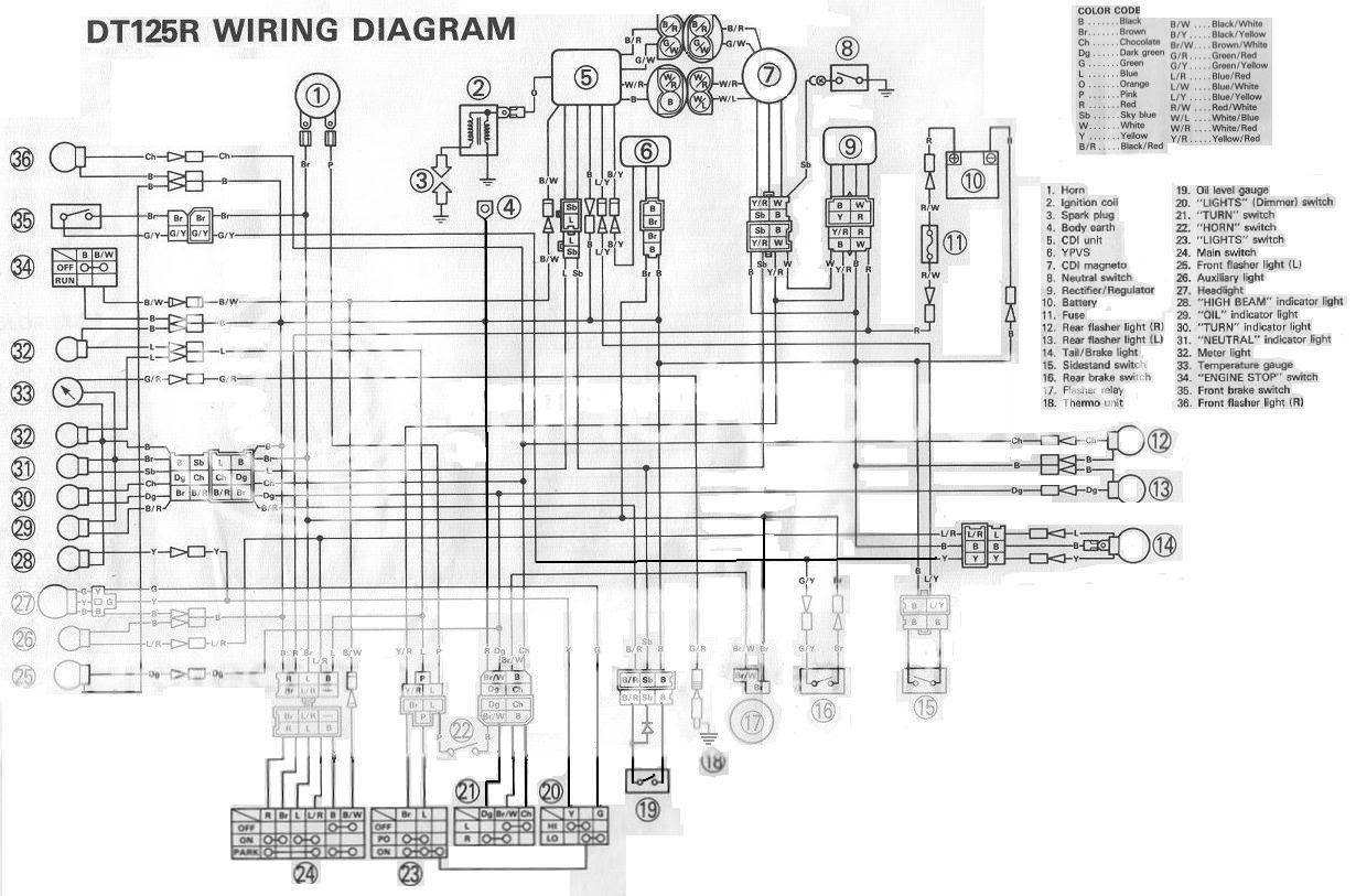

According to the Wiring Diagram, there is indeed only one fuse -so check for loose, broken or damaged wires, loose or corroded connectors.
