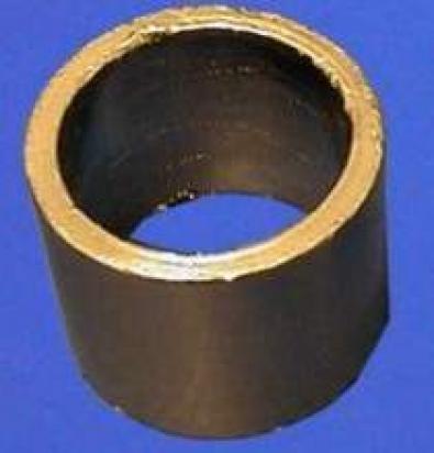

PostPosted: 09:49 - 15 Apr 2015    Post subject: Reply with quote
hazza wrote:
hopefully the issue is that they couldn't be arsed to spend the 30 quid on graphite gaskets and just tried to 'fix' old knackered ones with putty.
Sure looks that way.
Pending an "they're all like that" correction, that looks like there's a gasket missing there. There shouldn't be a gap that big that needs filled, and putty's always going to crumble out of there.
Wemoto suggests these or something like them should be in there:
https://images.wemoto.com/full/GASKET_EXHAUST/10016409.jpg
