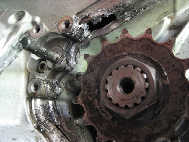

Your biggest risk of mechanical damage, outside of crashing the bike, is that the chain will snap and bunch up in front of the front sprocket, punch a hole in the crank case. This will mean a new engine and believe me it DOES happen.

PostPosted: 18:56 - 06 Sep 2015    Post subject: Reply with quote
https://s1.cdn.autoevolution.com/images/news/how-to-take-care-of-your-bike-s-chain-part-1-69738_8.jpg
https://www.apt-consulting.biz/pics/Broken-Chain-02s.jpg
https://www.apt-consulting.biz/pics/Broken-Chain-05s.jpg
https://i5.photobucket.com/albums/y165/boatrman/Husky%20misc/IMGP4629.jpg
