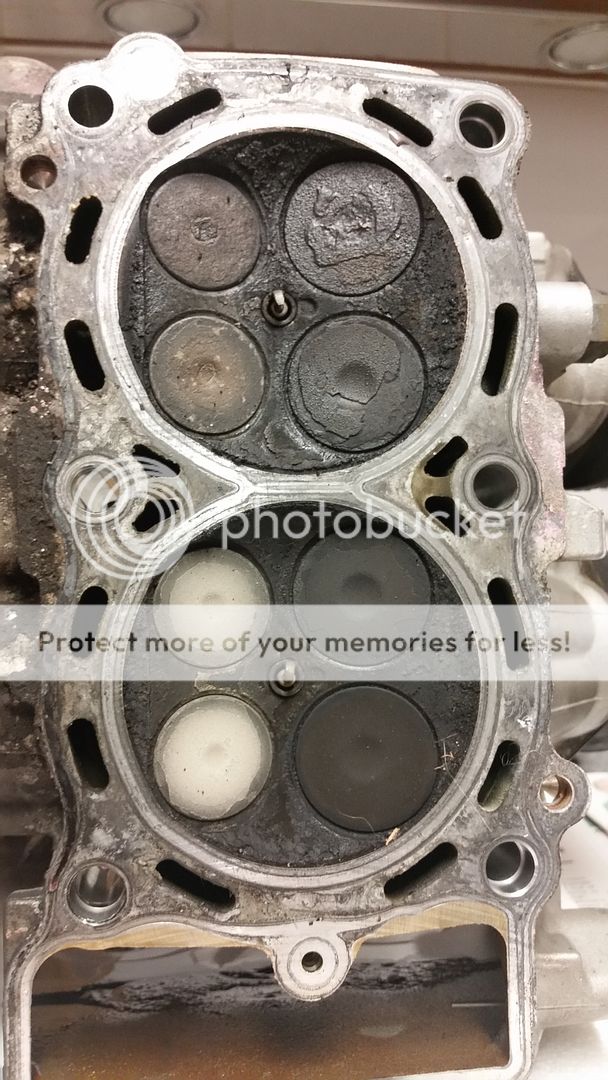

Had the engoine apart this weekend and its a valve problem. The Right hand cylinder is running consoderably hotter than the left which with the low compression suggests an air leak possibly from a piece of carbon caught under a valve head.
https://i945.photobucket.com/albums/ad297/750RK/Odds%20and%20ends/20150809_210346.jpg
In fact the right hand cylinder is so hot it has burnt away most of the carbon deposits.
Next step will be to pull all the valves and take a look at whats going on under them.
Pete.
PostPosted: 05:47 - 11 Aug 2015    Post subject: Reply with quote
You going to clean up all that carbon before pulling the valves?

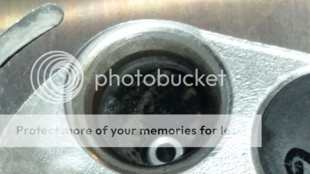

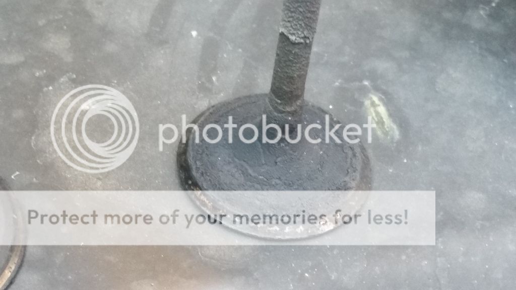

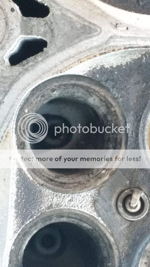

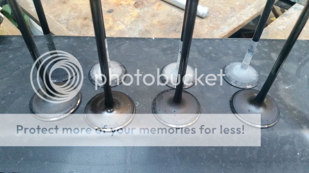

So got the head apart and this is the state of the valves...
https://i945.photobucket.com/albums/ad297/750RK/Odds%20and%20ends/20150815_191528.jpg
As you can see the inlets aren't too bad, they would last a fair while longer before needing redressing, the exhaust valves though are a mess. The valves should all have a ring of shiney metal where they contact the seats and the constant contact should keep them clean which hasn't happened here.
A close up of the exhaust valve shows just how bad they are...
https://i945.photobucket.com/albums/ad297/750RK/Odds%20and%20ends/20150815_191547.jpg

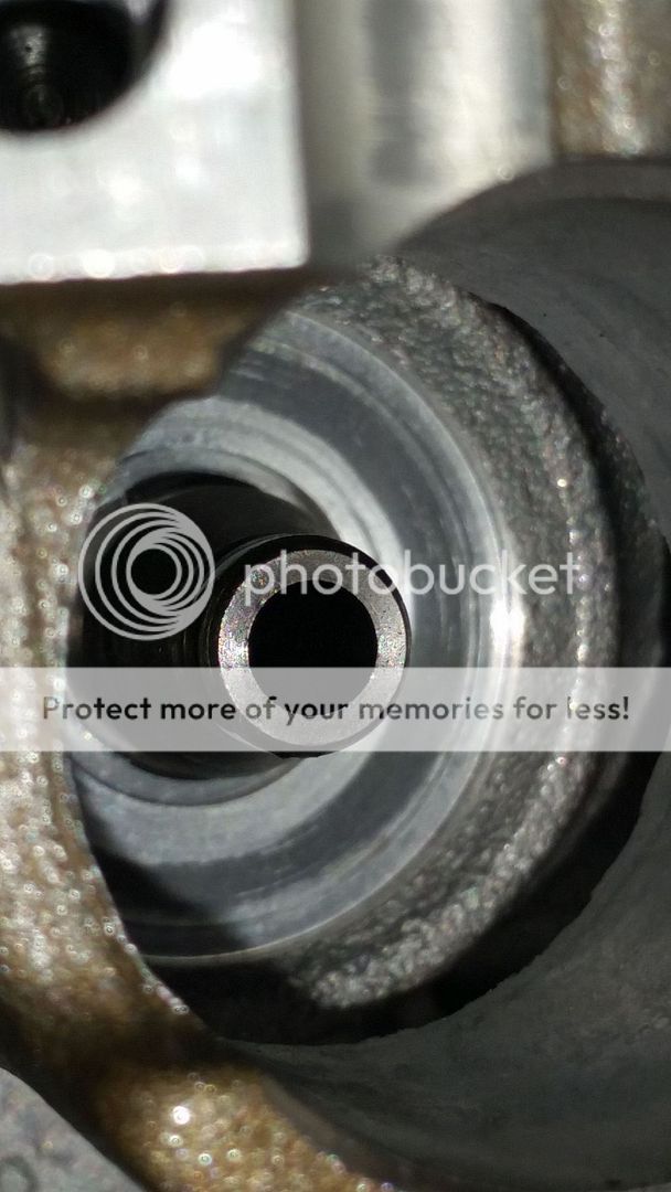

Heres the exhaust valve seat...
https://i945.photobucket.com/albums/ad297/750RK/Odds%20and%20ends/20150815_191649.jpg
So as you can see, no clear shiney band on either the seat or valve so no gas tight seal even under pressure of combustion.
The inlet seats are better but not by much...
https://i945.photobucket.com/albums/ad297/750RK/Odds%20and%20ends/20150815_191705.jpg
It is usual for the exhaust to be rougher than the inlet but generally not to this degree.
Pete.

I wouldn't worry about the running condition going by the colour of the vales, because that's going to change when it's been worked over anyway. I'd be worrying about how deep you're going to have to cut the seats in the head to get rid of all the pitting.

Its not pitting as such, looks more like deposits but yes it does concern me how much we have to play with.

So I've been to the cylinder head chap and we've had a chat. His opinion is the exhaust valve guides are shot and that has promoted bad seating of the valves getting worse as more deposits are left. He is surprised at the amount of wear and wouldn't expect it at such a low mileage but engines are becoming a throw away part. He also said that it could simply be down to modern petrol and the additives such as ethanol taking their toll as engines aren't really designed for it.
He believes the valves should be fine but we need to compare them against new guides before a final decision is made.
Matt has said he should theoretically be able to get away with removing 0.005mm of metal from each surface to cut the seats and redress the valves so taking a total of 0.010 and after checking with Kawasaki we have just over 0.5mm-0.75mm to work with so hopefully we can get away with this. Lets hope it works.

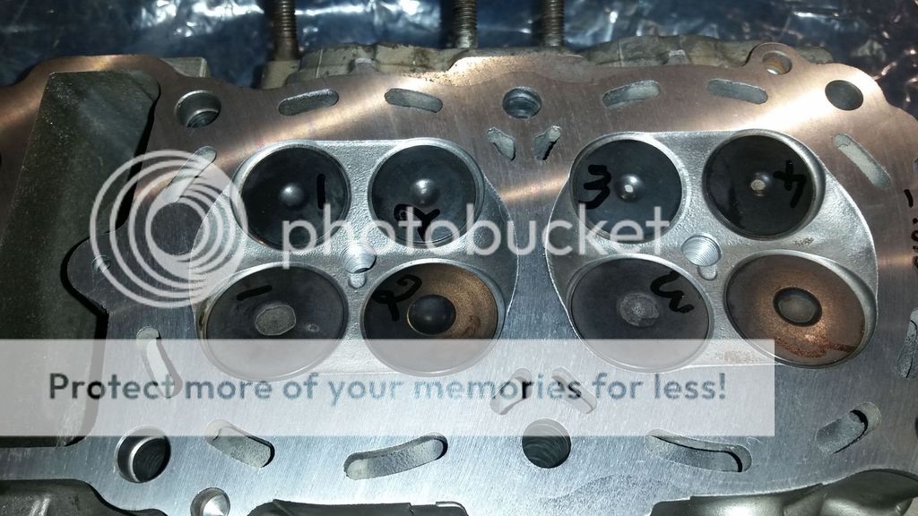

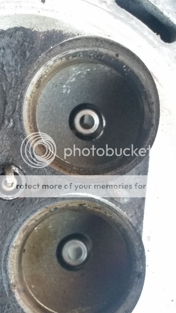

The head is now back and looks a lot better. It's had all the work done including a 0.015mm skim.
https://i945.photobucket.com/albums/ad297/750RK/Odds%20and%20ends/IMG-20150918-WA0015.jpeg
New guides in place.
https://i945.photobucket.com/albums/ad297/750RK/Odds%20and%20ends/IMG-20150918-WA0006.jpeg
Exhaust seats sorted.
https://i945.photobucket.com/albums/ad297/750RK/Odds%20and%20ends/IMG-20150918-WA0013.jpeg
Exhaust valves redressed.
https://i945.photobucket.com/albums/ad297/750RK/Odds%20and%20ends/IMG-20150918-WA0010.jpeg

kramdra wrote:
Normal engines don't look like that, but it does seem a common problem for ER6's.
They do when they reach mileage but hey you know best, in fact you always know best because you've actually stripped and rebuilt lots of engines what with having worked as a mechanic and service manager so I will bow to your wisdom in this...
Lets not forget this engine is being stripped because it has valve guides that are worn and exhaust valves that aren't sealing.
And where are all these badly running coked up ER6's you refer to anyway?
