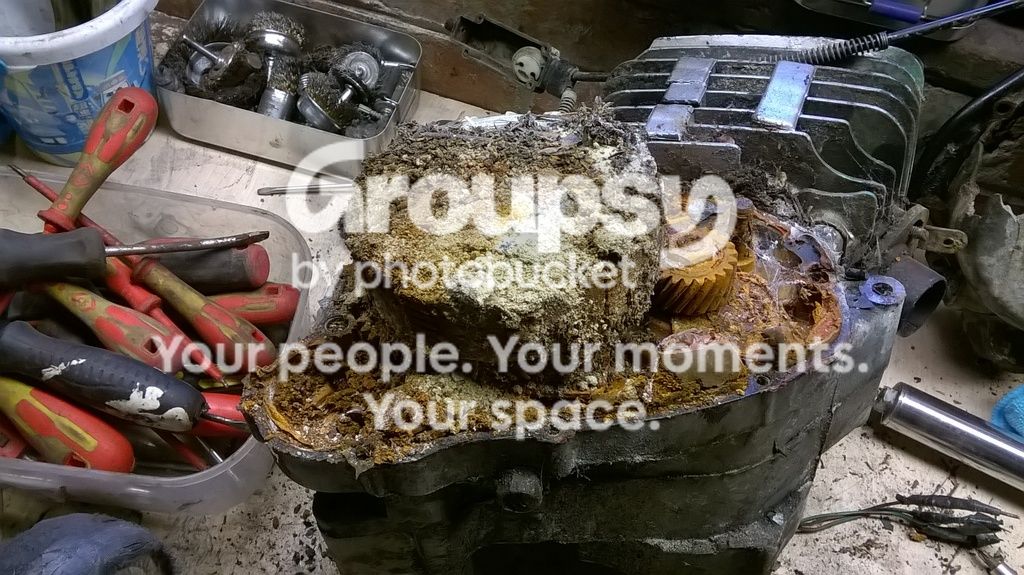

Was having a look at the bike I was given last night, it's a DT175MX that has been left on its side for about 8 years Shocked
removed the engine which is currently sat complete* in a plastic storage box.
Now every single fastener & bolt is rusted to shit, the engine will need a complete strip down. To make things easier on my self coudl i leave the engine soaking in something to hopefully make it easier to strip?
was thinking of something like diesel or kerosene, something that wont evaporate away quickly etc
*not really complete, the cover off the clutch side was left off so fly wheel etc is seized solid

cheers all, pics to follow of truly crustified (if thats not a word it should be) engine to follow
will get a few litres of kerosene an see how we go, im not in a rush to get it done so could just leave it soaking for a few weeks

You're doing a great job but b'Jasus that motors in a right state.
mudcow007
Joined: 01 Feb 2012
PostPosted: 20:26 - 24 Sep 2015    Post subject: Reply with quote
link to show an tell pics
its not pretty
