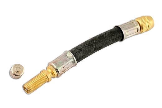

Alternatively these are pretty handy.
https://ecx.images-amazon.com/images/I/71St2Py2Z6L._SX522_.jpg
(Michelin tyre valve extension on Amazon.)
Well made, easy to fit, good access, little stress on the valve and then you remove before riding.
