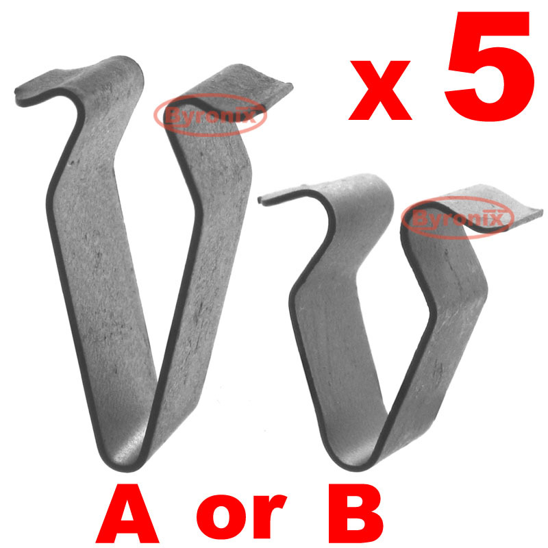

Can you not attach something like this to the back of the panel so it can still push into the grommet hole thing? Or bend one up to the right size out of a bit of strip metal.

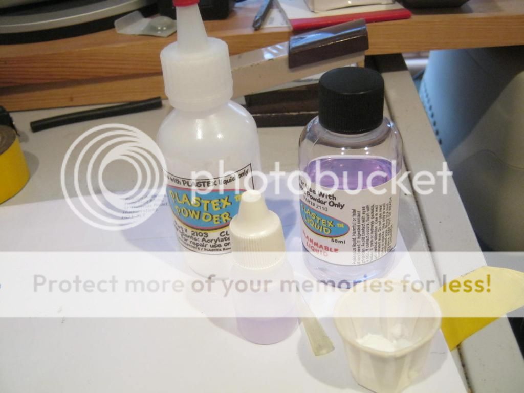

https://i1380.photobucket.com/albums/ah172/frankenbikestien/IMG_3542_zps74kifqdh.jpg
this stuff works well apparently.....not use it myself......
hi,
i have used this stuff before.
i dont think it would be any good for this type of thing Thinking .. its ok for sticking broken bits back together & even moulding replacement lugs that are missing, but not the push in plug type.
the moulding bar technique is only good for the flat type of lugs, those that slide into slots etc..well in ime anyway,
cheers,
GAZ
