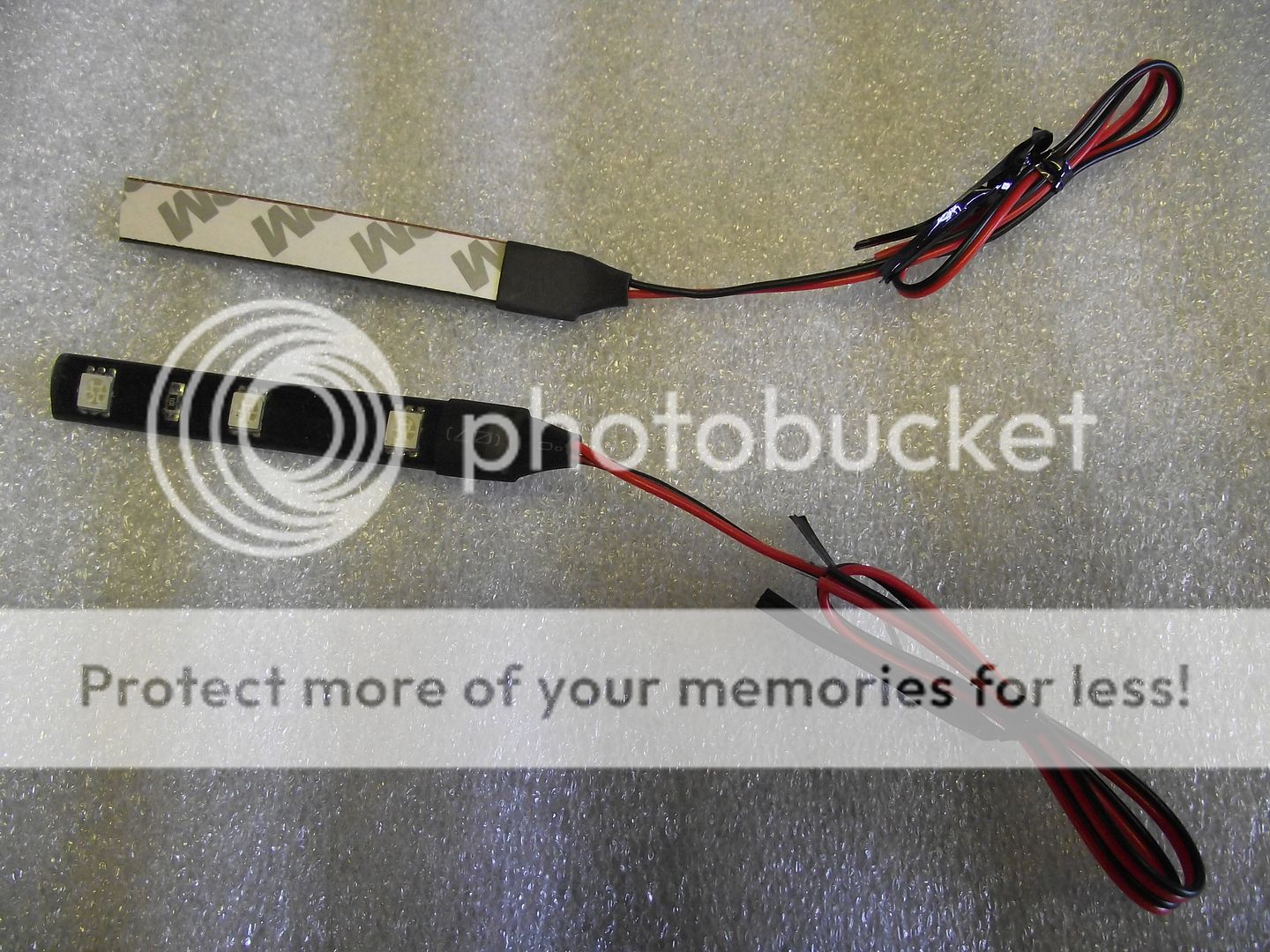

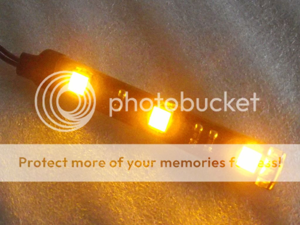

Recently I have purchased a set of hand guards for my dirtbike for some wind protection over winter, but on fitting them they cover the indicators, so I was thinking of getting a new set of indicators but found this on ebay instead:
https://www.ebay.co.uk/itm/Strips-LED-amber-indicator-marker-lights-leds-3-SMD-x2-/151312572882?hash=item233aeea1d2:m:mn3u8Coqgtu_J-k6aEXE50g
https://i1101.photobucket.com/albums/g429/abbones1/led%20strips%203smd/DSCF5223_zpsnv802mqz.jpg
https://i1101.photobucket.com/albums/g429/abbones1/led%20strips%203smd/DSCF2553.jpg
Would they just wire up to my existing wires for the orignal indicators? Or would I need to get something else too because they are LEDs?

If you leave the old indicators spliced in they will provide the necessary resistance to make them flash at a normal rate.
Or you could just change the indicator relay which is a £3 jobbie if you use a car one. Most are a three pin design.

£5 for a suitable relay
https://www.ebay.co.uk/itm/PRO-12V-FLASHER-2-PINS-RELAY-BLUE-FOR-MOTORCYCLE-MOTORBIKE-LED-INDICATORS-Z035-/170873685070?ssPageName=ADME:L:OC:GB:3160
