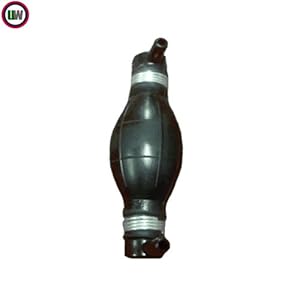

I think I'd trust a manual one more. Especially in a boat.
https://ecx.images-amazon.com/images/I/31pQrZb44xL._SY300_.jpg
PostPosted: 12:24 - 23 Oct 2015    Post subject: Reply with quote
Why? My present one is manual and I'm pissed off with it. What's your reasoning?

I thought you were meaning you had some sort of oddball mechanical lift pump running off the engine mechanism.
Cheapo electrical stuff doesn't last well on boats before it becomes corroded and knackered in my experience.
Every boat we've had has used one of those squeezy-bulb inline fuel pumps which has worked well. I seem to recall having something similar to manually prime one of the diesel pickups we used to use if someone ran it out of diesel.
I suppose a lot will depend on how far it's being lifted as to how much effort it requires though.
