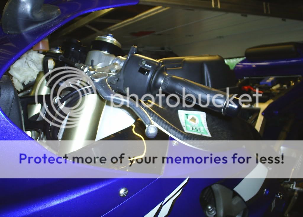

Nothing wrong with lock wiring the grips in place so long as the twisted end is pushed right back into the grip.
https://i666.photobucket.com/albums/vv23/WiNot_Rhencullen/Workshop/Picture040.jpg
As for affixing the grips into place I have always used Renthal grip glue.When I needed to remove the left hand switchgear so as to remove the clutch bracket for the new parts,I managed to remove the grip okay before cleaning everything up and reaffixing it with the Renthal glue.Finally,a twist of wire at each end of the grip ensured that it would not move again Thumbs Up
https://i666.photobucket.com/albums/vv23/WiNot_Rhencullen/Workshop/Picture402.jpg
