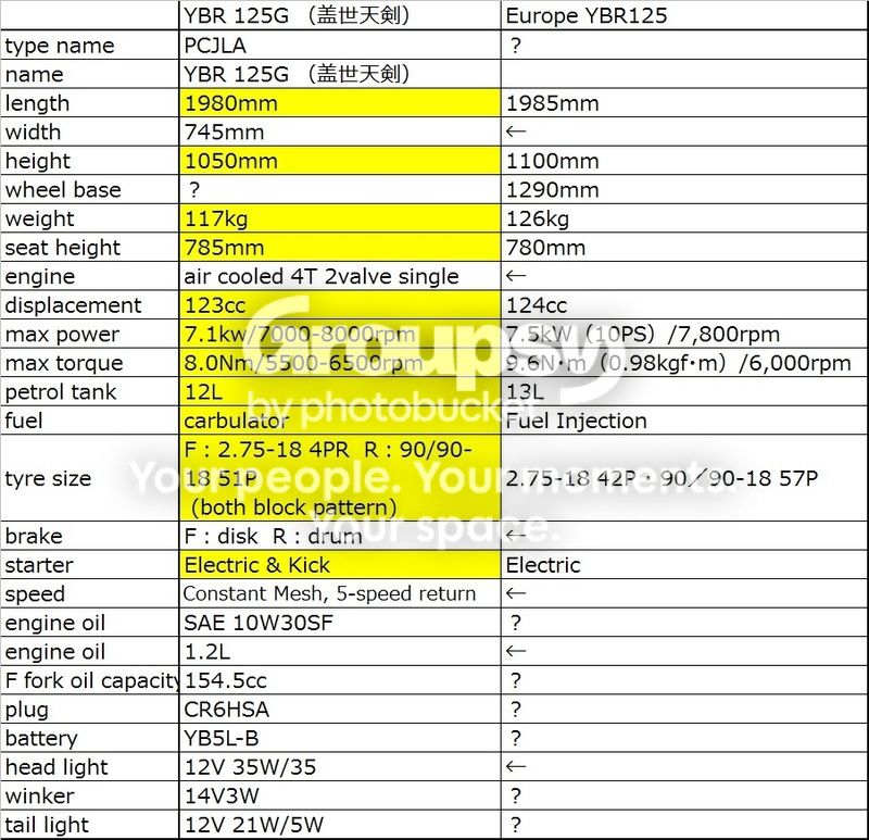

YBR125G is a off road look version of YBR125.
It has
-hand guards
-handle bar bridge and pad
-fork boots
-plastic under engine guard
-both kick and electric starter
and
-rear carrier is black not chrome
-shift pedal is normal type (not heel and tow type)
-block patern tyres
https://www.atlas-kk.co.jp/bike_detail.php?bike_no=131
https://i21.photobucket.com/albums/b295/kawashima_/YBR125G-002_zps8c9emmxu.jpg
https://i21.photobucket.com/albums/b295/kawashima_/comparison-02_zpseotgsbgw.jpg
YBR125 series line up
https://www.atlas-kk.co.jp/lineup3.php?mk=02&bn=YB
Variations of YBR125G
https://www.atlas-kk.co.jp/bike_detail.php?bike_no=008
https://www.atlas-kk.co.jp/bike_detail.php?bike_no=076
https://www.atlas-kk.co.jp/bike_detail.php?bike_no=077
I made above comparison table from no=077 page.
Please carefully check each pages (I can't tell which one is yours).
And YBR125G is grey import also in Japan. (Imported by Atlas-kk from China).
