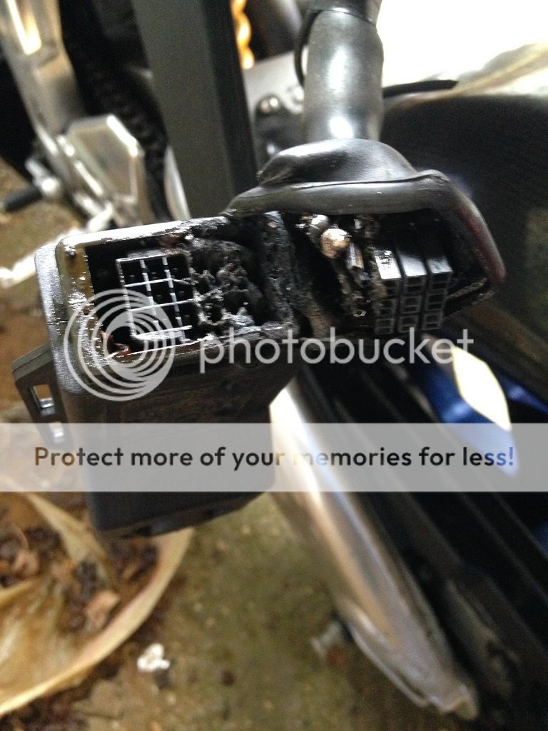

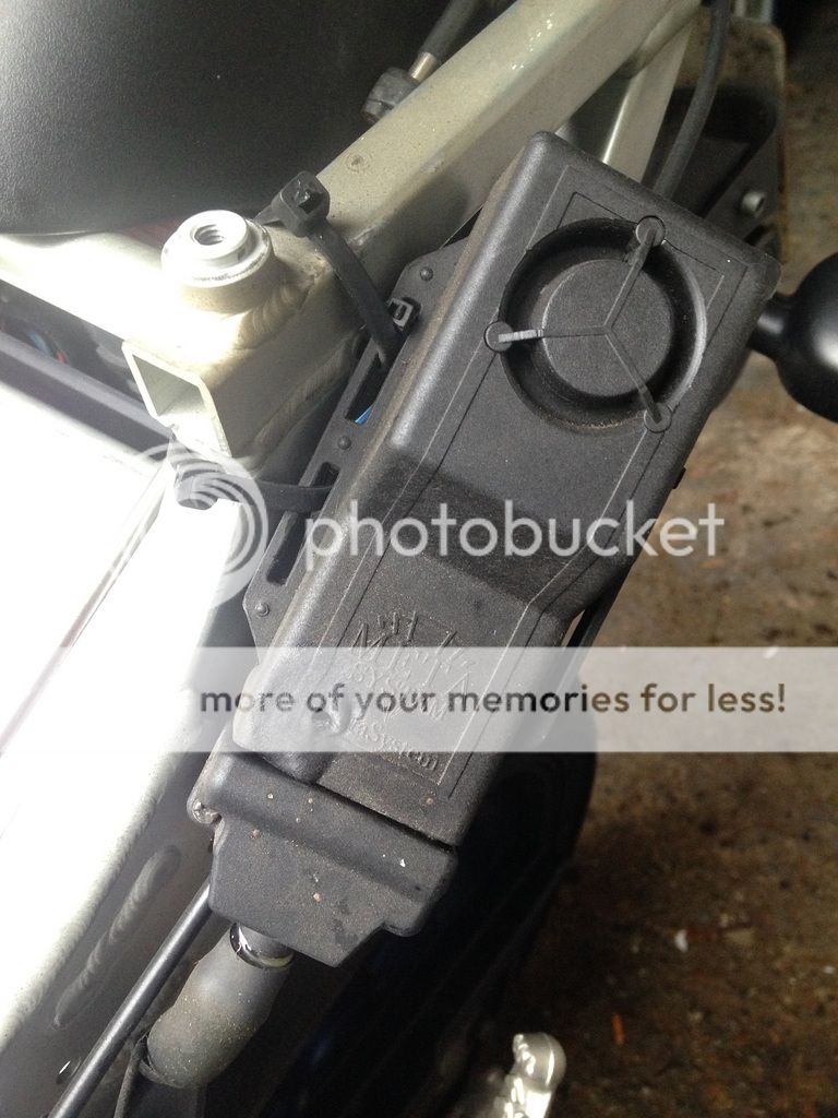

Mine did this at the weekend...
https://i979.photobucket.com/albums/ae271/RxsOllie/IMG_4824_zpscqg1j0zw.jpg~original
https://i979.photobucket.com/albums/ae271/RxsOllie/IMG_4829_zpsxozaplmx.jpg~original
As mentioned it's a case of tracing the wires to the corresponding circuits. Easy enough job.

As far as I'm aware, the bypass plug means the whole alarm box (as shown in Carvel's post), and fits on to the plug going in to the loom.
