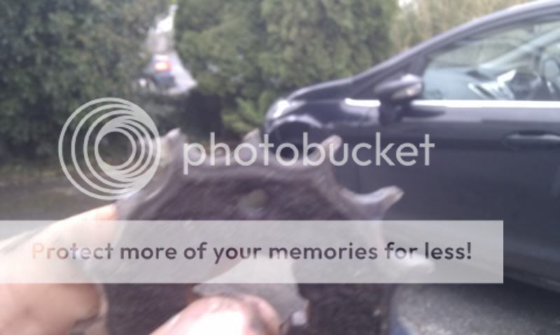

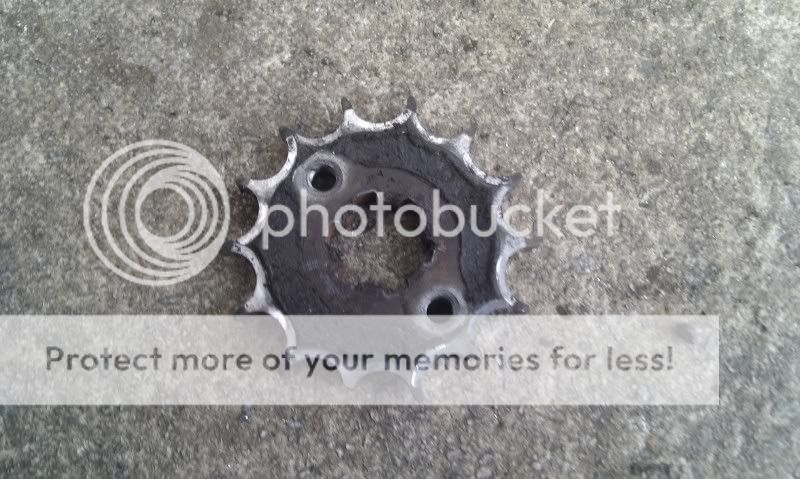

I went back and had another look yesterday morning, The chain wasn't on the back sprocket, so i took the chain guard and the front sprocket cover off to have a look. One of the teeth had snapped, and most of them are bent. I bought and fitted a new front/back sprocket, chain and clutch cable.

I have fitted a new rear and front sprocket and chain, The chain is the correct length. The front sprocket sit on the drive shaft fine and the splines are all good. I can spin the sprocket the shaft spins with it. The engine is no longer clunking or grinding either. When I put the bike into first the drive shaft starts spinning the sprocket/chain slowly, using the clutch does not make any difference (either the leaver, or where the cable attaches to the engine.
I have some (not very good) pictures of the old front sprocket (one of the teeth had snapped, and some of the others are bent)
