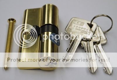

What you have is one of these:
https://i636.photobucket.com/albums/uu84/anadin96/patiolock.jpg
My first question is was the lock/key stuck before you tried removing the screw, or did that happen as you were trying to remove it.
The screw you have sticking out is the retaining screw that is supposed to screw through the threaded hole in the lock.
Is looks like you've cross threaded it, hence why it's stuck. You really need to get that screw out. I'd try very tight mole grips. See if you can get it to move a degree or two, then move it back, wait a few seconds for the heat to dissipate then repeat, + one more degree. If you're lucky the screw will eventually come out. If you're unlucky you'll snap it and have to drill it out.
Once it's out you should be able to waggle the lock (ie. what's in the above picture) until the key moves, the black lever in the picture will then move flush with the brass body and you can pull it out. If that fails then waggle the key and tap the cross bolt (bit that goes into the door frame) with a hammer.
It that doesn't work it's the nuclear option - drill out the whole brass body (steel in your case Shocked ).
TBH if none of that works I'd consider a new door.

it would appear the lock itself has jammed solid... the procedure is to break the lock inside the door: at the point where the 5mm bolt holds it in place: using a monkey wrench or large spanner this is the weakest point.. see jpg. above... this requires a degree of skill...

Has that euro-cylinder been "snapped", in the way that naughty feeves are supposed to "snap" them?
grr666
Joined: 16 Jun 2014
PostPosted: 17:22 - 28 Feb 2016    Post subject: Reply with quote
Yes, but it hasn't broken where they usually do because some Abloy 1* rated (or more) locks have hardened steel
centre section which takes a lot more force to break than the first cylinder pictured in this thread which is a hideous cheap
thing with an embarrasingly weak spot. https://i636.photobucket.com/albums/uu84/anadin96/patiolock.jpg
