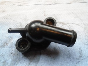

The Internet suggests this could be the thermostat housing:
https://i.ebayimg.com/00/s/MTIwMFgxNjAw/z/bvwAAOSwjVVVrOJS/$_35.JPG
https://www.ebay.co.uk/itm/2012-DERBI-125-4V-WC-TERRA-GPR-MULHACEN-SENDA-THERMOSTAT-HOUSING-COVER-AOK-/261974513934

PostPosted: 01:06 - 21 Mar 2016    Post subject: Reply with quote
RhynoCZ wrote:
I think it might be on the side of the engine, possibly a pipe going to it from the rad so I'm thinking that's it I will double check in the morning would it be simple to remove it? And I should replace with a new one
S.farrow
RhynoCZ
Joined: 09 Mar 2012
PostPosted: 01:15 - 21 Mar 2016    Post subject: Reply with quote
No need to replace the housing, be careful not to damage the seal under the housing (if you do damage the seal, then change the seal). Very simple to take it off, just 2 bolts and the hoses. Or at least that's what I get from the picture. Thumbs Up

It looks like the only seal that's there is a rubber O ring. So make sure you don't rip it apart, if you do, then buy a new seal (generic).

I will take it off in the morning then I will order a new thermostat and replace it then I will get back to you if it Carrys on over heating thank you very much for your help Smile
