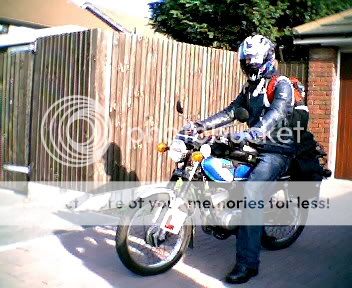

It's pretty standard TBH, my RXS was nothing special just in good nick it would do 70 with me on it Laughing
And yes it did look ridiculous on it Laughing
https://img.photobucket.com/albums/v295/chris-red/photo001.jpg
