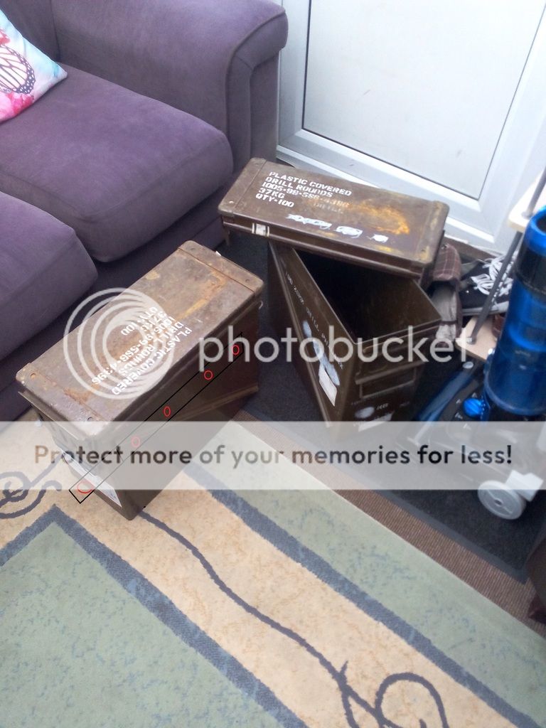

I have my military panniers (that say on them they can carry 37kg of ammo).

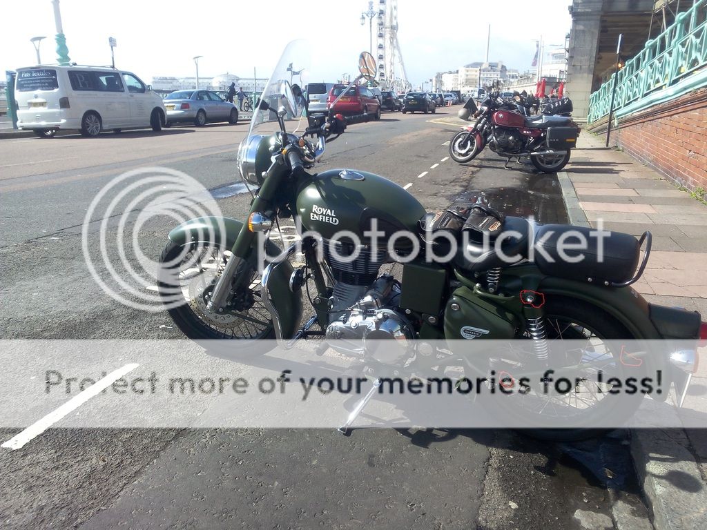

My enfield, which has a few spots that I can bolt brackets to.

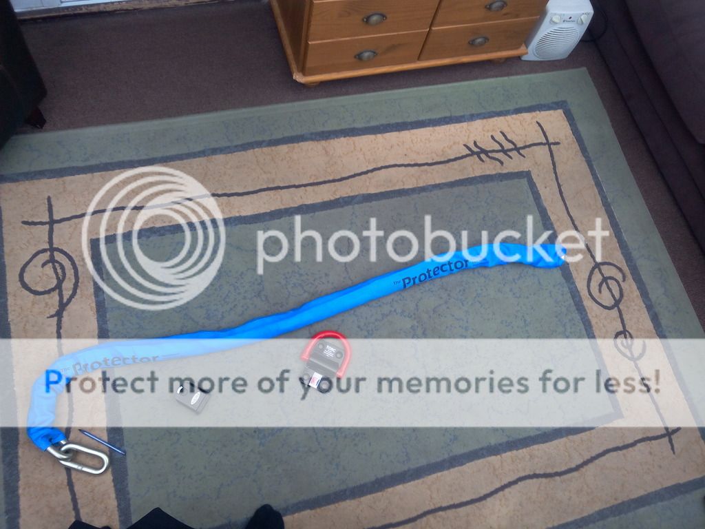

What weight can I put in them? I have this massive chain and lock that I was hoping to bring with me on my travels. the chain is 14kg and 2m long. Worst case I have to cut the chain in half and put half in each pannier, and get another squire lock to join them.
It sounds silly but Im taking this bike abroad and I need it safe.
ive sort of bodge painted my idea of a 3mm-4mm bracket, I'd put another at the bottom of the pannier too, and have them bolt up to the ringed bolts on the bike.
and at the rear of the pannier Id have some U bolts with rubber mounts.
I feel fairly confident the enfield frame can handle the weight, I just want other experienced users ideas about the strength of the brackets. I wouldnt want to overload and snap anything.

I wouldn't worry about the bike frame taking it. It can take a 100kg rider + 100kg pillion with no trouble. Thing things to consider are the strength of the frame you build to hold the panniers, and vibration.
From the pannier frame, angle or box section is much less likely to bend than flat bar. Rubber washers and nyloc nuts to absorb and mitigate vibration.
PostPosted: 09:56 - 08 Apr 2016    Post subject: Reply with quote
I've used ammo box panniers before.
The trouble with ammo boxes is that the sides tend to split so just bolting them through the sides is a no-go.
You can use repair washers on the inside but I've even had heavily loaded ones split round the periphery of the washer.
Best bet is to either put a piece of ply on the inside of the box the same size as the inner wall or make your mounting with a piece of L-section along the bottom supporting the majority of the weight.
Your bike is designed to carry a pillion who could be over 100kg and sits higher on the bike than a set of ammo boxes.

Hm. Ill line the inside with some ply or sheet metal then. I have pannier racks but they wont fit these boxes.
Also i looked at the india ones and the boxes are quite small. As in would fit enough for a trip for two. Yours are 15cm wide whereas mine is about 21.
I will fit a rack in between both and fit another rack for the chain. Thatll spread the weight.
