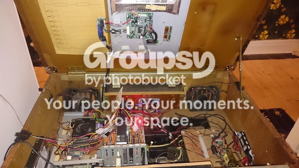

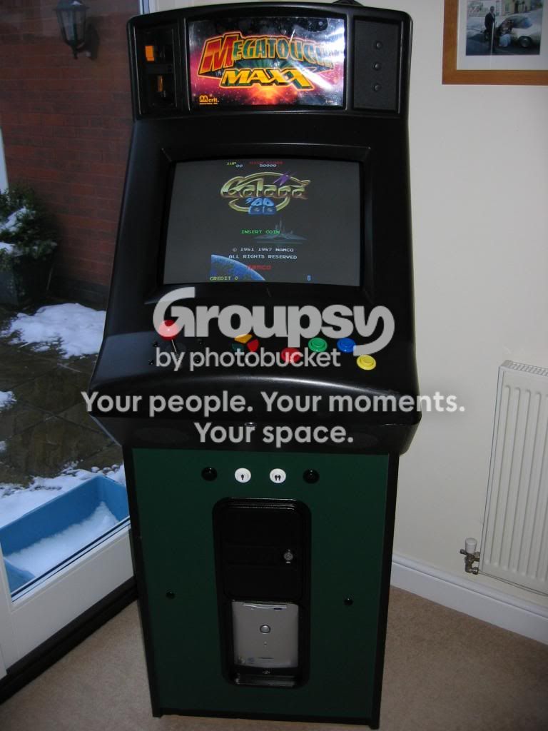

Mine used an unwanted PC that was donated and a cabinet that came from Gumtree. The cabinet had an old wiring loom, the monitor and speakers included which made it easier. Once MAME was up and running on the PC it was just a case of drilling holes for the joystick and buttons and wiring them into the encoder.
One thing I did add afterwards was an Act-Labs light gun for shooting games. An easy job with a box that plugs between the PC and the CRT monitor and a USB connection.
I sold it eventually. Being a full size cabinet it took up too much room and the construction under the plastic bezel meant that there was no room for dual controls. If I was going to do it again it would be a much smaller build. I did look at running it with a Pi but the PC was a freebie so I went with that.

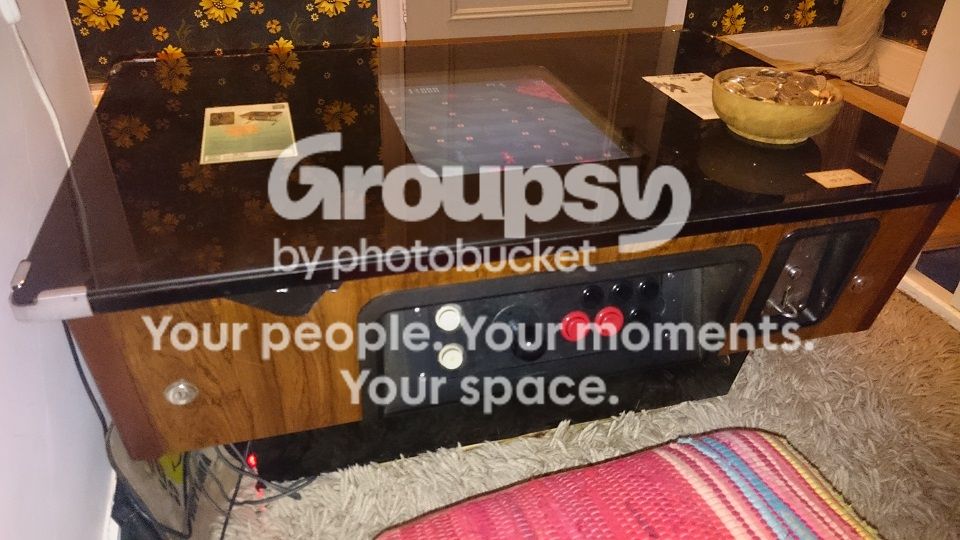

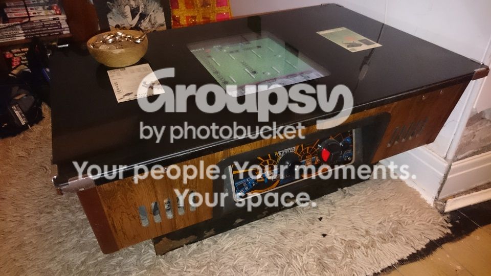

Not so much a build as a conversion. Still a work in progress but here's my efforts so far with an old 1978 Space Invaders II table I've had kicking about since the mid 90's.
https://i100.photobucket.com/albums/m6/Bumpinguglys/DSC_0267_zpsvcigbas2.jpg
Player 2 side. Sanwa microswitch joystick, 3-way button (same as the one on Matt's but painted with acrylic) and a single button 4.
https://i100.photobucket.com/albums/m6/Bumpinguglys/DSC_0268_zpsyrhmxwyh.jpg
Player 1 side: Ultimarc Ultrastik analogue joystick (based on Sanwa hardware), 2 full size buttons (red), 4 low profile (black). The fascia has been removed from this side to accommodate the buttons and everything mounted onto MDF.

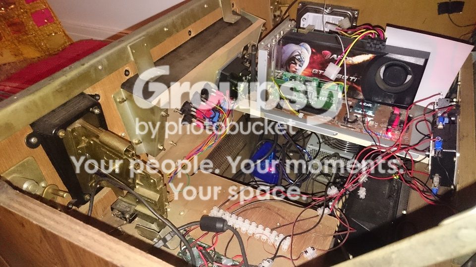

Inside: Stripped 15" monitor screwed directly to the lid. Wooden batons supporting an old gutted PC. Rats nest wiring from the Sanwa joystick and some remaining original electronics (P1, P2, Coin) soldered to cannibalised PSX controller plugged into USB converter plugged into PC... Rolling Eyes PSU and speakers are in the base. Intake fan on the left hitting the CPU, Northbridge, memory and HDD, exhaust fan on the right.
https://i100.photobucket.com/albums/m6/Bumpinguglys/DSC_0270_zpsk3lm3gqx.jpg
Inside: Can really appreciate the difference between the Ultrastik and the Sanwa here. No fannying about with converters or creative wiring, the Ultrastik plugs directly into USB and has its own wiring loom supporting up to 8 buttons, with the 8th also acting as a 'shift' button, to give 15. It was expensive but I can't recommend it enough. Analogue too, so it's good to go for Outrun, Hang On etc.
Think the CPU is an Athlon 64x2 6000, graphics is a Geforce 560TI (not that it makes a difference in MAME), 4GB ram if memory serves. Performance is pretty good up until mid-90s polygon-athons or processor heavy roms; Ridge Racer and Gauntlet Legends spring to mind. The Front End I use is MALA; everything is controllable via joystick and buttons, just have it auto start from Windows.
The monitor is a bit small, but I wasn't prepared to mutilate the lid; you sit very close anyway so no biggie. Most two player games will run in cocktail mode, so horizontal split-screen with the 2P flipped and it works surprisingly well.
There's around 4000 games on there, and that's a pretty pared down list. Realistically 200 would be more than enough, there really is a lot of shit old games as well as the classics.
