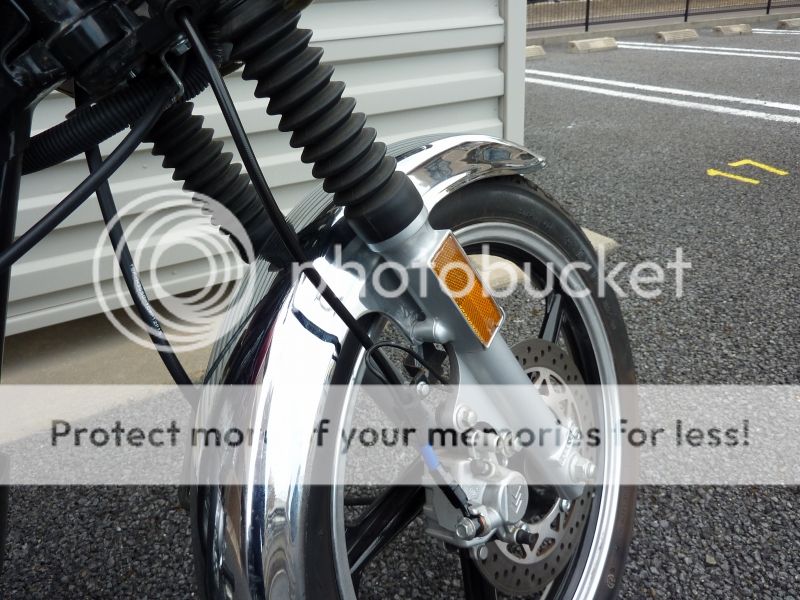

Can you show us a picture of the brake?
I ask because I wonder if your model has the proper Yamaha caliper, or the smaller caliper that Jianshe-Yamaha fit to their own brand version of the YBR.

Hi Roger san, this is the caliper of my YB125SP.
https://i21.photobucket.com/albums/b295/kawashima_/YB125SP_zpsqce91vc9.jpg

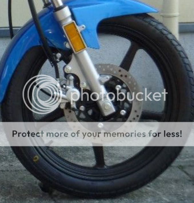

This is YBR125(post 2007) caliper.
They look a little bit different, they have same pad size though.
https://i21.photobucket.com/albums/b295/kawashima_/YBR125_zpssnyp91ny.jpg

YBR calipers have always been fairly average and from memory are all the same caliper (part number) but there is two distinct versions of the same part.
One is a chinese made caliper for the late model ybrs and the other is an italian made version for the early ybrs, in all honesty i cant say ive noticed an actual difference when it comes to the braking side. Yours looks like a later chinese version, you can try getting your hands on an earlier one but tbh im not sure your be impressed with that either.

HH sintered pads and a braided hose will improve it. That brake disc looks no good, try to replace with a cast one if they are available.
PostPosted: 17:07 - 24 Jun 2016    Post subject: Reply with quote
Difficult to tell from that picture, but it looks like the disk has been damaged by worn out pads at some point
Katy
I've done 4000km(2500miles) on mine with genuine pads. I hope it's not damaged yet, I ask the shop to check it on Sunday too Thumbs Up
edit
I remembered why there is scratch on the disc. Embarassed
https://www.bikechatforums.com/viewtopic.php?t=309886
I forgot removing disc lock on mini touring and started, caliper support was bent, I had to ride it back to home using front brake too.
Pads touched at different angle to the disc and made scratch on it.
(when caliper support was changed to new one, they said disc was ok)
