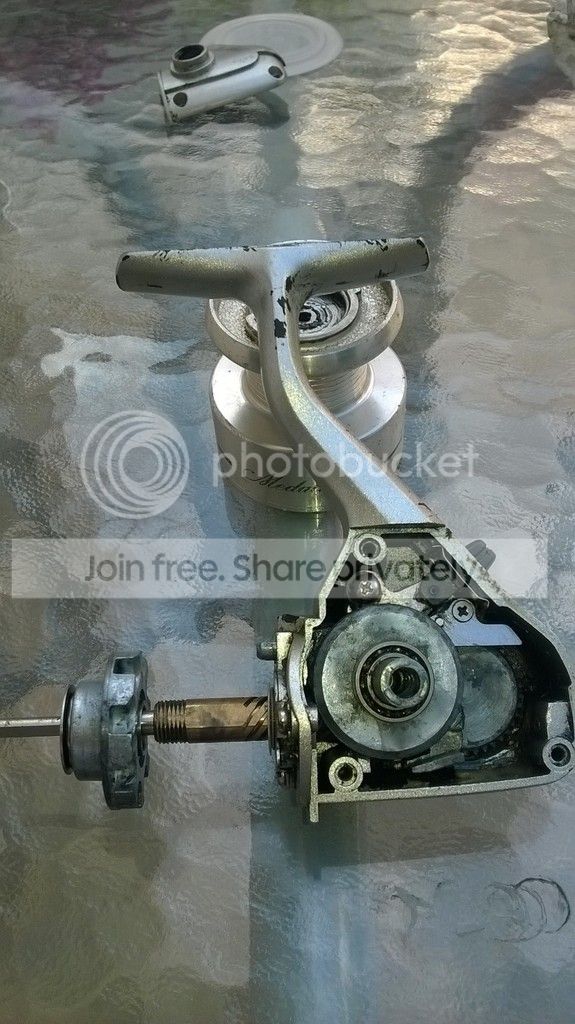

Photo 1:- This is with the "anti reverse switch" in the off position.
https://i62.photobucket.com/albums/h105/DameCeliamolestrangler/image_zpsjth0rvjs.jpeg

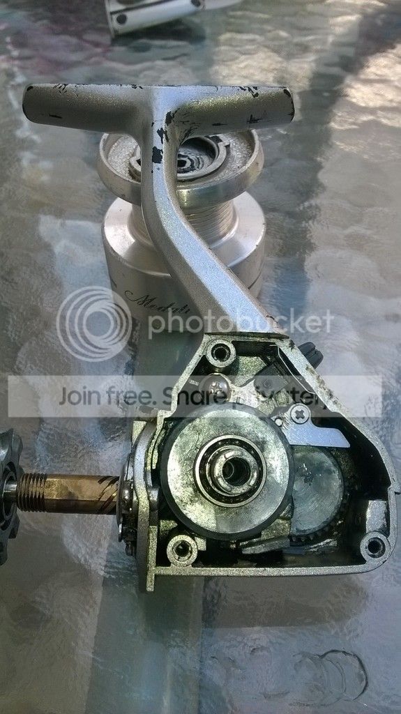

Photo 2:- With the "anti reverse" on.
https://i62.photobucket.com/albums/h105/DameCeliamolestrangler/image_zps2uzhs41e.jpeg
As far as I can see all that happens when the switch is in the "on" position, a lug is pushed into place which engages with the, castellated, inner spool thing!
Since taking the photos I removed some excess grease and reassembled it, now when the anti reverse is on, all that happens is it is now difficult to turn the handle in the normal retrieve direction and still no "anti reverse".

The castellated inner spool thing should house the one way anti reverse bearing, is this the part you have disassembled and cleaned?
It looks different to more modern reels, well mine anyway, disassemble it and post a picture.

Looks like you may have cleaned the gears instead of the one way bearing, lightly grease the gears and put a drop of oil on the bearings that are visible then strip the one way bearing inside the castellated part that sits under the rotor , clean and lightly grease the needle pins, make a note of everthing in order as i can't find a reel schematic for this reel.
