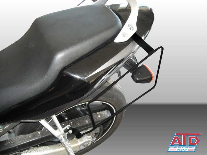

These are touted as "soft bag support", but do you think you could attach hard panniers?
https://www.ebay.co.uk/itm/HONDA-CBR-600-F3-SOFT-BAG-SUPPORT-/141677414797?hash=item20fca1c98d:g:1FIAAOSwrklVZNAy
https://i.ebayimg.com/00/s/NjAwWDgwMA==/z/1FIAAOSwrklVZNAy/$_57.JPG
https://i.ebayimg.com/00/s/NjAwWDgwMA==/z/ziwAAOSwKrhVZNAy/$_57.JPG
If not, is there anywhere that could make a pannier rack?

Those soft pannier supports need extra reinforcement to be able to hold hard side panniers. They are missing a under loop to prevent them from twisting inwards too.
TBH don't have them made from scratch. Have something modified as custom made is very expensive.

A wingrack wouldn't be hard to adapt on to those types of fittings even though they don't do the universal kit anymore. Or have you checked the measurements on osmething similar? Wouldn't surprise me if grab rail is standard size and you can bend the footpeg bar.

Current design of that top bracket will bend.
