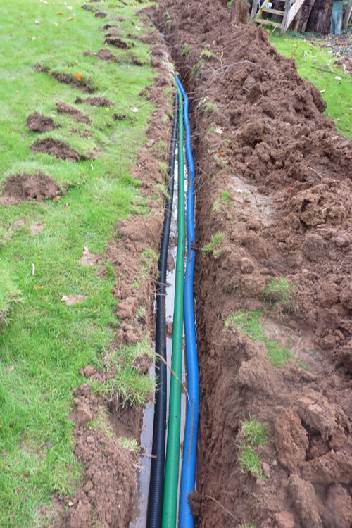

Sorry, bit late but just got back from holidays. If you're going to do it with a 13A plug, I'd forget the consumer unit. Just connect the sockets up directly and use a 5A fused spur for the lights
If you do it properly, yourself, look into voltage drop and earthing regulations. I had to use 3 core 10mm armoured cable, which costs £££, to connect up a couple of outbuildings. I did the majority of the work myself and got an electrician in to connect it up to the main and submain fuseboxes. The garden eventually recovered from the mess. Since I went to the expense I used conduit and put in water and a spare too.
https://www.amigo.co.uk/obsy/37.JPG
