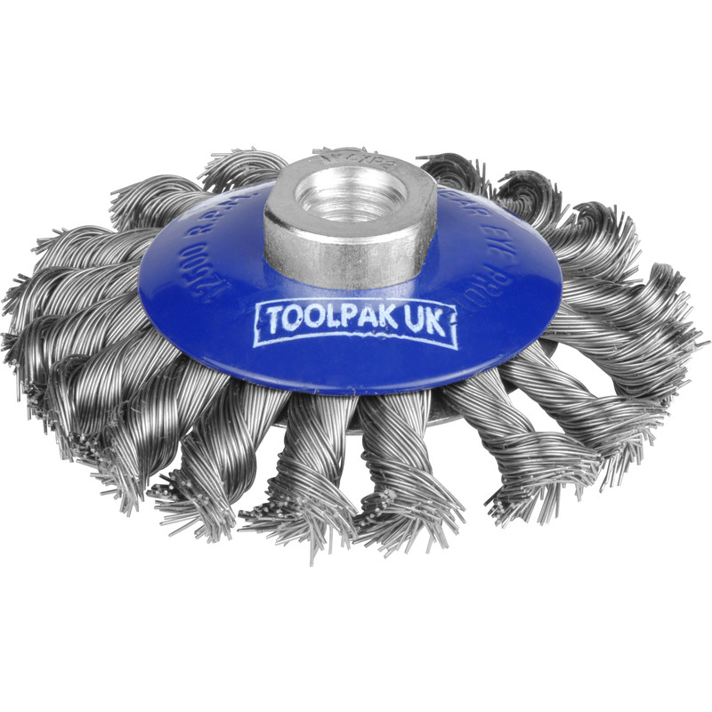

Some of these;
https://cdn.toolstation.com/images/141020-UK/800/21989.jpg
On a 115mm angry grinder (~750w, blue Bosch ones are around 35 ponds and I've always had good luck with them) will run off your genny. It will be a slow job but short of getting a sand blasting setup I think you'll be fairly limited.

Careful with the buffing cups. I once used one on a full speed grinder (18,000rpm?) and when I was finished my overalls looked like a hairbrush.
