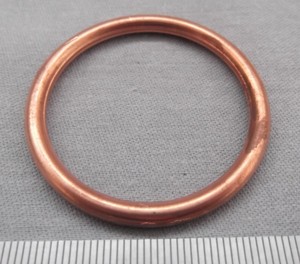

What motorcycle are we talking about? There is supposed to be a seal of some sort there, such as a copper ring.
https://i.ebayimg.com/00/s/MTQwNlgxNjAw/z/8IwAAOSwpzdWrN42/$_35.JPG
