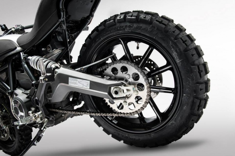

PostPosted: 15:56 - 25 Aug 2016    Post subject: Reply with quote
Roadholding and practicality are not #1 on everyone's list.
https://2.bp.blogspot.com/-3mOW-jWz4T0/VjtTFUf3OTI/AAAAAAAAPYE/LrmSGuy-HlA/s1600/ducati-scrambler-dirt-tracker-6.jpg
