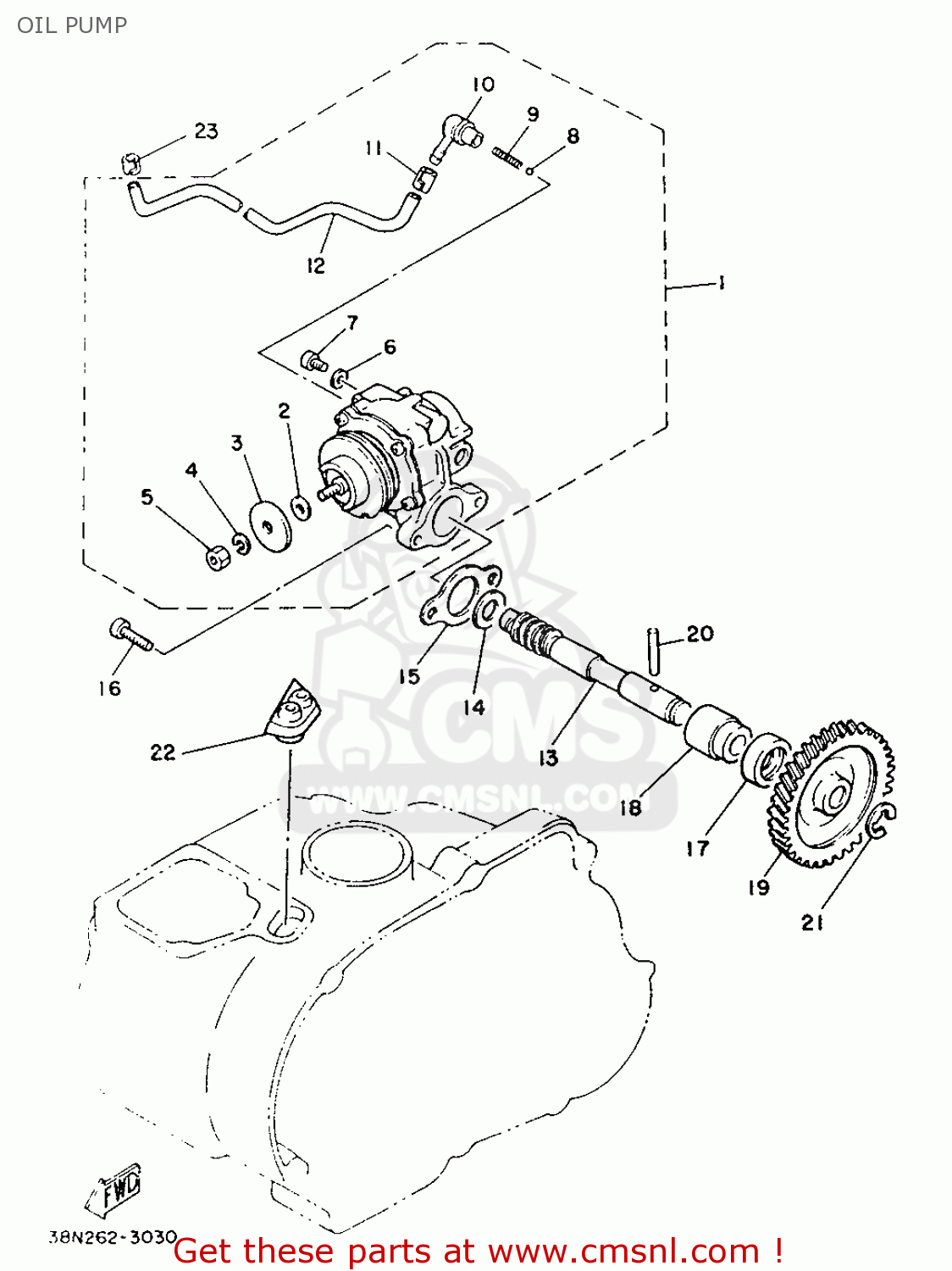

https://images.cmsnl.com/img/partslists/yamaha-yb100-1987-18n-england-2718n-310e1-oil-pump_big3IMG00984289_831b.gif
are you talking about number 17??
or am i looking at the complete wrong place.
have you got a seal/oring puller?? best £3 tool ever,
hammer it into offending seal and lever it out.
also bloody handy on fork seals.

PostPosted: 17:33 - 07 Sep 2016    Post subject: Reply with quote
It'll be part 14. Although it looks like there's a paper gasket in there too which I wasn't aware of.
I'll see about pulling the pump and seeing properly where it's coming from. The overspill seems too dirty to be 2-stroke (and doesn't smell of strawberries).

PostPosted: 23:25 - 07 Sep 2016    Post subject: Reply with quote
sorry i meant 14.
surely if oil was getting past that seal, then there'd also be air/fuel as well and you'd be able to feel it when the bike was running.
does your pump inject oil on both side of the crank or just the intake side,

PostPosted: 23:59 - 08 Sep 2016    Post subject: Reply with quote
ok, i get ya,
so the pump has nothing at all to do with the crank.
and you reckon its possiblly gear box oil
having a look at the diagrams, id say you'd be able to get out any seal with out having to split the crank,
seal puller for the win
