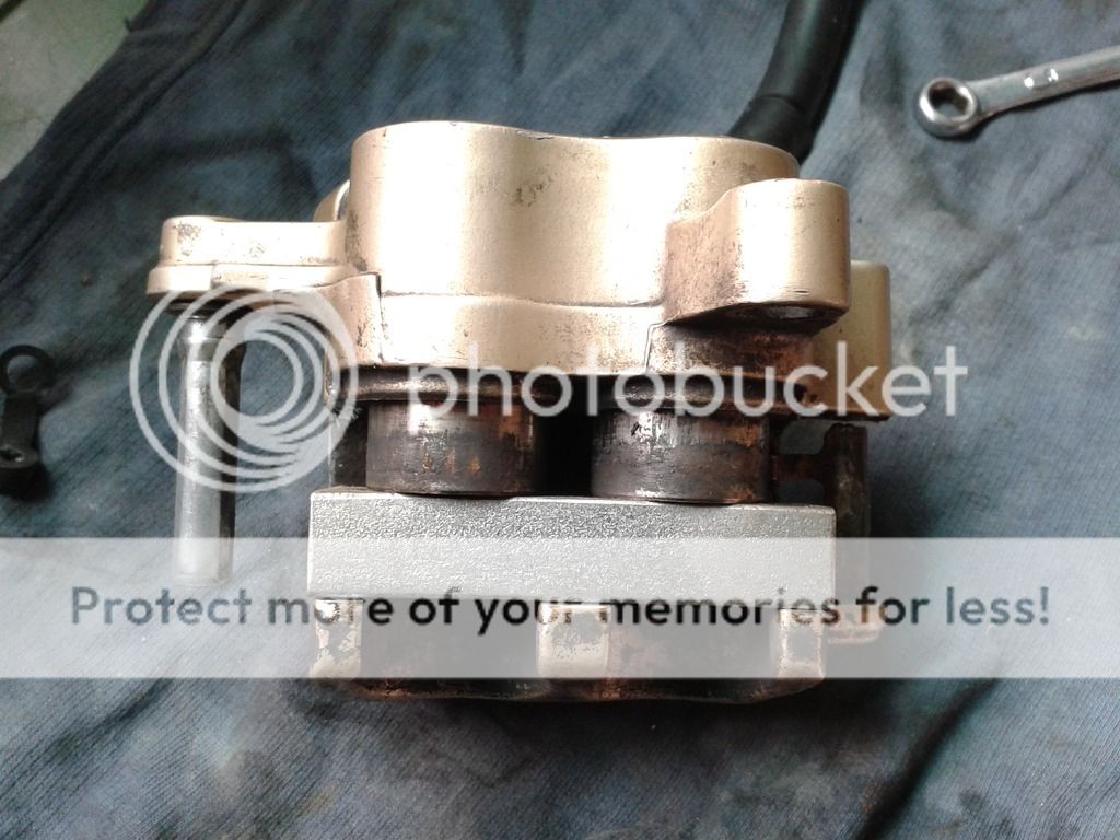

Here is how I deal with stuck pistons.
I use a spare master cylinder bolted to a spare handlebar held in a vice.Then I connect them together and bleed the system.
https://i666.photobucket.com/albums/vv23/WiNot_Rhencullen/Workshop/20160527_105059_zpsalhacskw.jpg
Gradually the pistons begin to move,no matter how stuck they are.Air would not move these as they were too seized in place

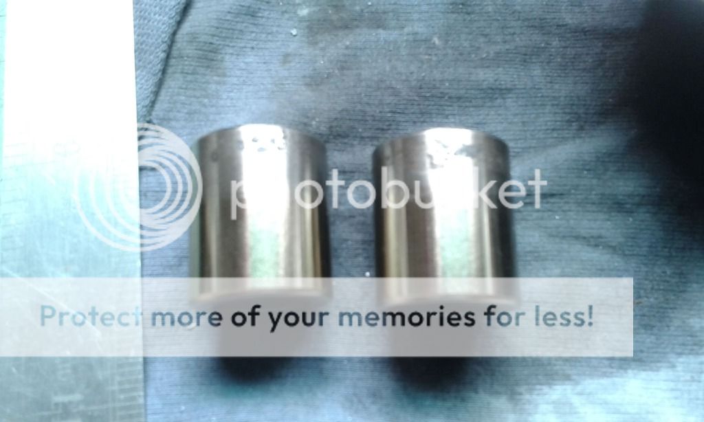

Until the pistons were all of the way out
https://i666.photobucket.com/albums/vv23/WiNot_Rhencullen/Workshop/IMG-20160527-WA0004_zpsjdadzxjg.jpeg
https://i666.photobucket.com/albums/vv23/WiNot_Rhencullen/Workshop/IMG-20160527-WA0006_zps5rtqu2va.jpeg
Then it was just a question of carefully hooking out the dust and distortion seals,cleaning up the ring lands,using red seal grease or new brake fluid to lubricate the seals and reassembling the caliper.
If the pistons are as dirty as in the second or third picture,it is not worth just cleaning up the leading edge.Far better to pop out the pistons and clean everything.Otherwise the caliper will need more attention within a very short period of time.

pictures can be misleading/deceaving, would i re use those pistons and seals, no . want to know why??
