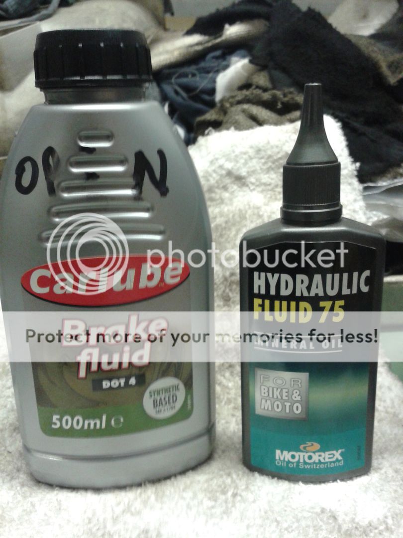

The DoT 4 that I use is this,which is silicone based

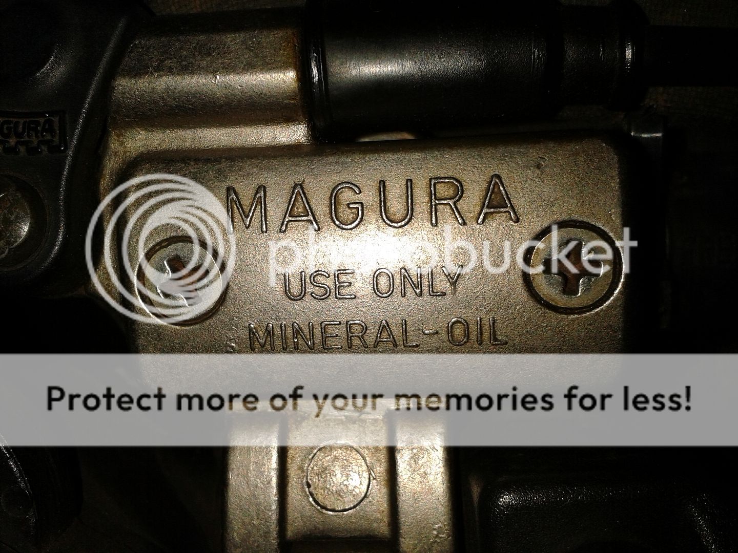

The mineral oil is specified for use in the Magura clutch fitted to my KTM enduro.Later Brembo clutches on KTMs use Dot 4 or better,as in DoT 5,which has a higher boiling point but is still silicone based

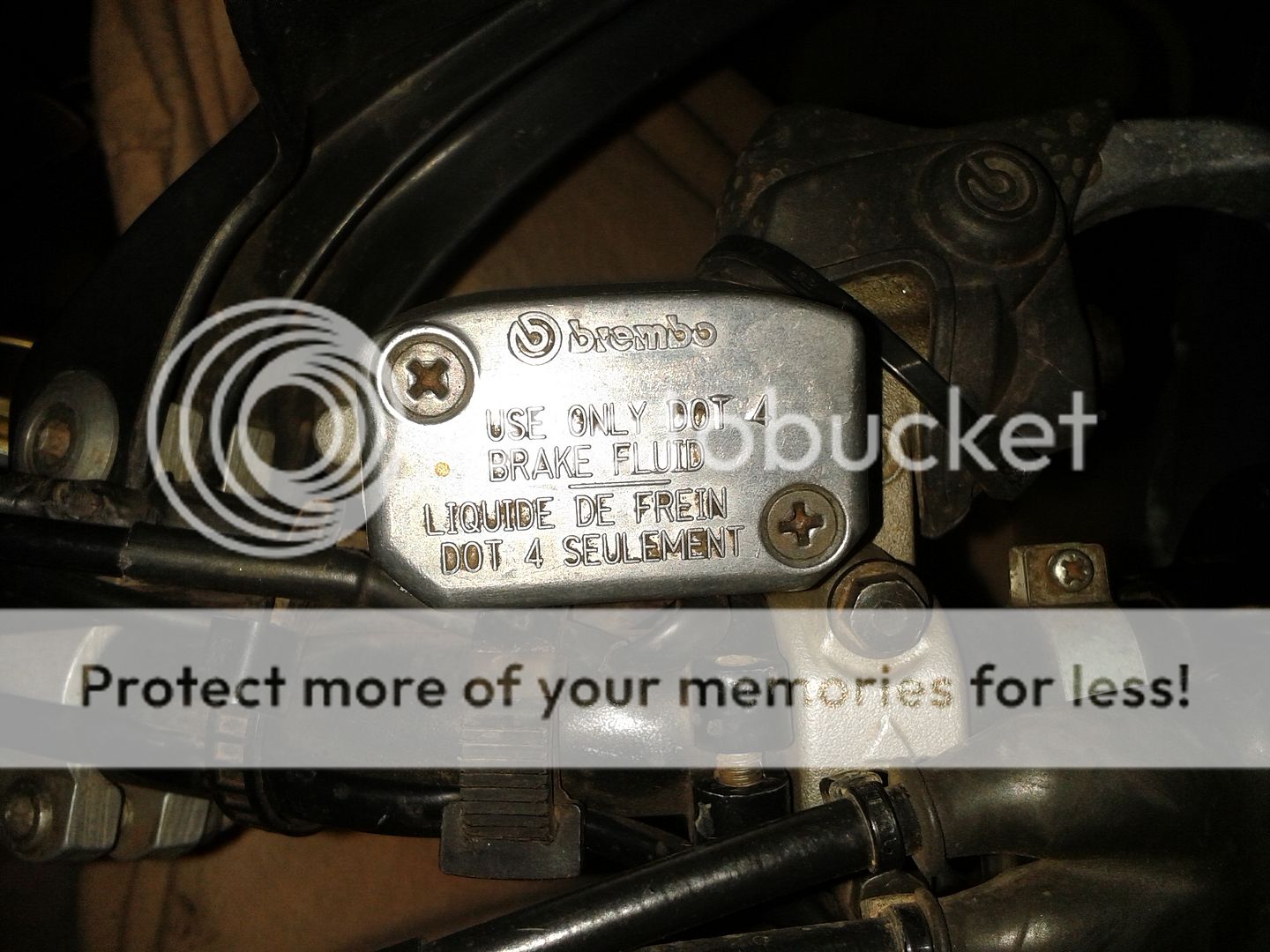

The reservoir caps usually give an indication about what specification fluid that should be used
https://i666.photobucket.com/albums/vv23/WiNot_Rhencullen/Workshop/20160912_181538_zpskagzwu35.jpg
https://i666.photobucket.com/albums/vv23/WiNot_Rhencullen/Workshop/20160912_181623_zps3lrtemay.jpg
As for the fluid in my clutch,the manual specifies mineral oil only.This does not need to be replaced as often as a DoT 4 or 5.1 fluid and the bleeding procedure is quite different to brakes Thumbs Up

As Motorex sponsor KTM,the recommendation is to use that sold by them.
I have found that Putoline make a cheaper but similar quality mineral oil Thumbs Up
