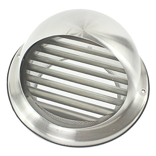

A plain vent/grill and internal non-return valve is what I'm going for when I find someone man enough to drill a hole in my kitchen wall for it (the local bricks have black lumps in which are notorious for fucking core drills).
It needs to keep birds out.
I intend to use one called a stainless steel bull nose with insect mesh. Easy to use, easy to clean.

Cheers stinkwheel!
That looks ideal for what I need on outside wall and being Stainless it would match the porch exterior light too. Thumbs Up
