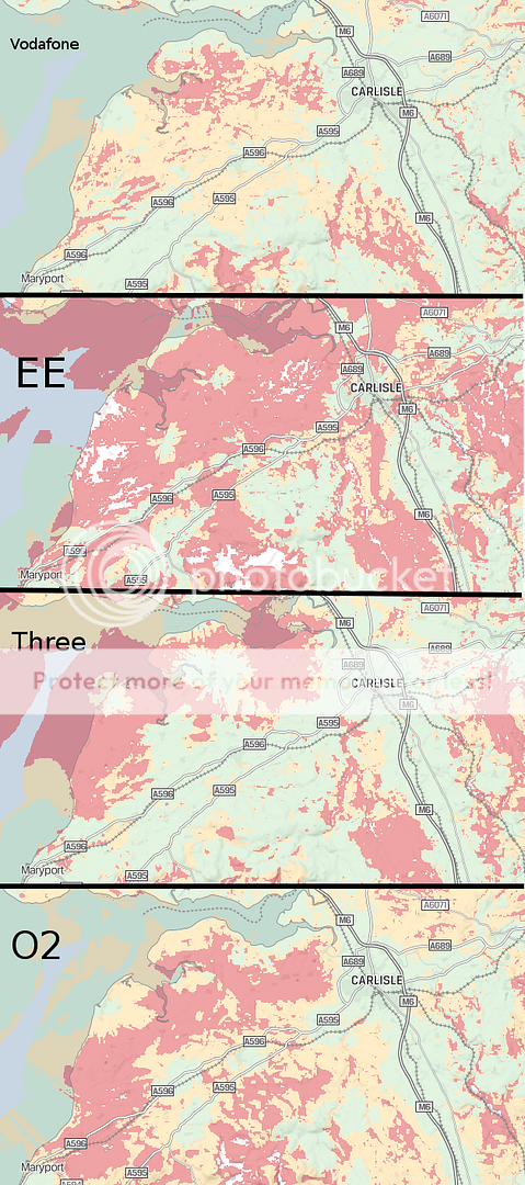

https://i48.photobucket.com/albums/f216/stinkwheel/phonecover.png
That's 2G coverage indoors according to offcom.

However, any other network Laughing Brick Wall
Vodafone have the best coverage it would seem...
